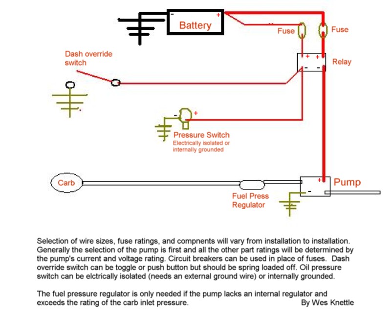

I purchased my M37 about a year ago, and put two new matching batteries in it. It ran great for that year after some work, but now I have charging issues. I get 28.5 volts when the truck is running and about 25v when it is off, shortly after running, but it is not holding a charge. The problem is the fire dept I bought the truck from tapped 12v from one battery to power the 12v fuel pump. I think this is a bad idea in a series battery system as it leads to an unbalanced system. I would like to replace the 12v electric fuel pump with a 24v model. Do you guys have a pump model which works well?
I would also like to run the fuel pump power through a relay which closes when the engine is running. I have heard of using the oil pressure sender, but am unsure how to wire it. Currently the pump runs as long as the ignition is on.

If you go to the website m37.crwdesigns.com/index.htm, he has an excellent wiring diagram and explaination about what you want to do by wiring it to the oil sending unit. Click on the technique section and scroll down till you see it. It even has a photo of the setup.

Snowdad, thanks for the great link. That was exactly what I was looking for. I was wondering how to use the oil pressure sending unit, when an added pressure switch needed to be added. I am not sure if I will go electric, or put on a new mechanical unit, like Mikkelborg did. I like the simplicity of the mechanical unit, as long as it works as well as the electric pump. I currently have a negative disconnect, the ignition switch, and a 12v switch for the fuel pump. I need to turn all three on or off. Are there modern rebuild kits for the original fuel pumps which work with modern gas? I would like to keep the vacuum boost of the original
Re: 12v fuel pump in 24v vehicle?
Yes there are modern kits in the $80 range.
Here's a wiring layout for use with a relay.

FYI, marine (sailing kind, not beach storming kind) applications are all 24V. I got a 24V marine diesel fuel pump with 4PSI out for my truck - works like a charm. Just remember to mount it near the tank, as they push better than they suck.
Along with a 5PSI oil pressure switch, I hooked a 60A zeener diode inbetween the starter switch and the + in on my pump. That way, the pump gets power while my foot is pressing the starter. Gets rid of the need for an override switch. And, yes. It is fused in all the right places.
