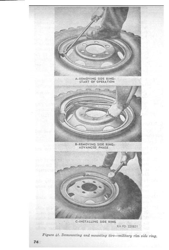

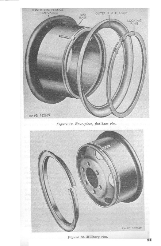

You can decide for yourself what value the illustrations from the TM have!

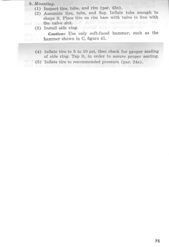

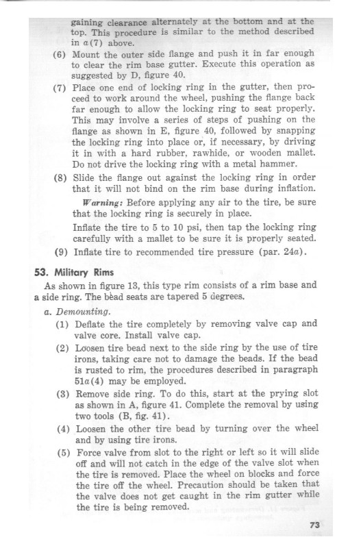

Re: NDT bead breaking
Here's the pages specific to the M37 wheel. There are many more general procedures pages that carry a great deal of important information and are accompanied by many useful illustrations. I have worked on dozens of aircraft types and many had split ring wheels and I still feel we need to refer to manuals to cover that small percentage of times we just plain forget an important step.

Nothing wrong with manuals, however the folks that wrote and illustrated them don't know it all either. The illustration that is labeled removing ring, advanced phase shows a prying procedure that will irrepairably damage the rim. I have done it years ago myself and have seen many ruined by others as well using this procedure. What happens is if the ring is rusty or a little stubborn to remove as they often are, prying against the rim can easily bend the edge downward deforming the ring groove. Once this happens, the rim is junk as the lock ring will no longer fit correctly making the assembly very dangerous to inflate. We never pry against the rim except to carefully start the lock ring removal; once past the slots provided for this, finishing the job working the ring off as I described in a previous post will totally eliminate the possibility of rim damage as a result of prying. It works well and doesn't cause further heartaches than you had in the beginning.
That illustration can be misinterpreted. I see two irons resting on the sidewall and the operator is lifting them. As one can see there is hardly any useful space between the operator's hands and the wheel center for him to be pushing down. The illustration would have been better presented from a higher angle so one could see where the toe of the irons are resting. The danger of damage to the wheel center retaining lip comes when the irons are held almost vertical and used to force a ring outward and free from the wheel center.

Not so, I've never done it with irons held vertically, never pryed outward to remove a ring. I still like my method much better as the iron never touches the rim at all, thus absolutely no chance of damage to it. With my method, the iron only contacts the under side of the ring and the end touches the tire only. All action is outside of and away from the rim, only one iron needed and it works well. Why take the risk? No need that I see.
I do not do it with the irons verticle either. What I said above is that I see the photo from a different perspective relative to your perspective. I believe the operator in the photo is lifting against the tire and is NOTprying against the wheel. I stated that there is not enough room below the operator's hands in the photo for him to be able to pry down against the wheel with any useful advantage. I am NOT disagreeing with your technique. I am disagreeing with your interpretation of what the operator in the photo is doing.

I have no clue what the guy in the photo is doing, how could anyone, we can't ask him. What anyone may interpret from an illustration doesn't make it the fact, because we don't know for sure . At times a picture is indeed worth a thousand words, but unless it comes with a full description of absolutely what is going on, it may not be worth spit. All I'm saying is I like the fool proof method better as it removes all doubt. I've taught my method to all my guys here, it works well for all who do it. You can also do it any way you like too, it doesn't make any difference to me.
