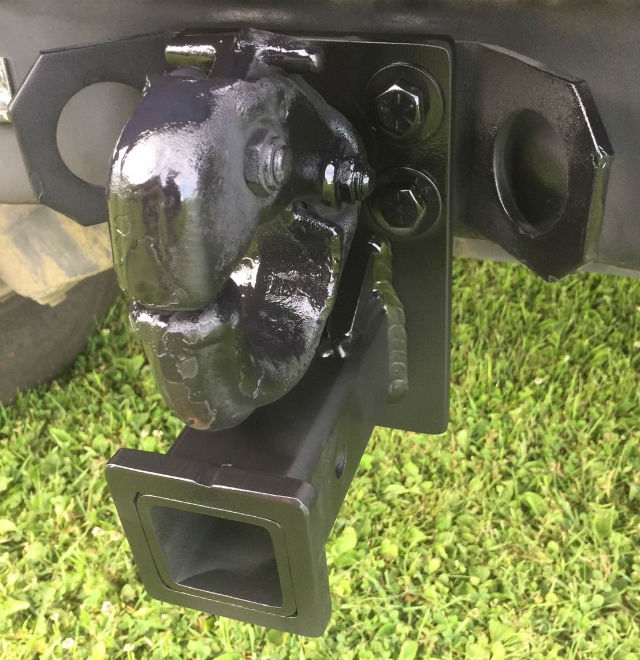

Well Friday night and Saturday I fabricated the Hitch plate. I went with the over the cross member to provide maximum clearance for the winch when off roading. It's a little tight to install with the bed installed, but it can be done. http://m37.wawii.com/
The top picture I posted (http://m37.wawii.com/images/DSC00059_Hitch.JPG) collection is of the hitch as fabricated. I used existing bumperet and pintle hitch bolt holes for mounting, however I will need to drill two more holes vertically up through the hitch and cross member to secure it better from twist. Drilling two 3/4" holes upward over your head is no fun, sure wish the bed wasn't installed.
The middle picture I posted (http://m37.wawii.com/images/DSC00066_HitchInstalled.JPG) collection shows the hitch installed and with various items inserted into the receiver tube. The pintle hitch sticks further rearward than stock, but it's not like I plan on using it to pull a trailer, just pull other folks out.
The lower picture I posted (http://m37.wawii.com/images/DSC00078_RearWinch.JPG) collection shows the winch from several different angles. You can see in the lower left image that most of the departure angle is preserved. The winch bracket has a loose fitting 2" tube, and I think I might tack a couple of shims to it to take out some of the play, other wise it will wobble a lot when bouncing along the trail.

Nice, but I wouldn't pull anything too heavy with it on the ball hitch. A lot of leverage on those bolts.

We would do some additional reinforcement gussets from the back side of the receiver plate to the cross member. This way there would not be so much load riding against only the attachment bolts .

after seeing many bent rear xmembers terry thought it best to spread the load out.
