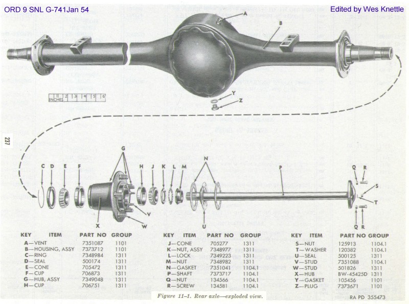

Does anyone have a good diagram they can post of the rear axel berrings? I have to take mine apart tomorrow and want to be sure I get everything back in order. I have the manual but it does not show the breakdown of the rears.
If you know where on the internet I could look you can post that

Thanks so much............ Just what I was needing
