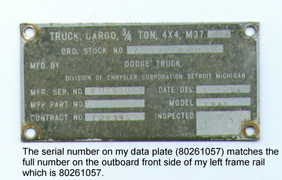

Re: serial number location
Mine 80261057.JPG (135.18 KiB) Viewed 942 times
Post by MSeriesRebuild »
Some early trucks did host the full # at both locations, however most do not have the complete # except stamped into the rail. We see one once in a while like that, but really not that often.

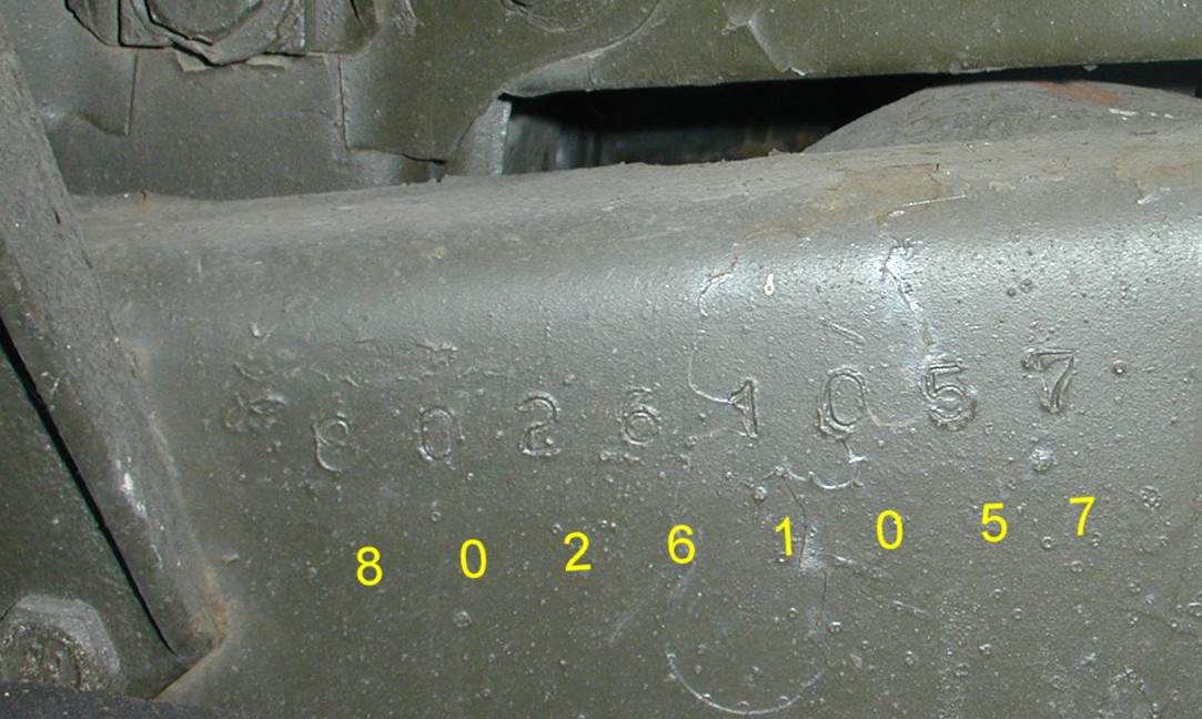

54 is not very early for an M37. Perhaps the shorter number is a M37B1 thing?
Here's a photo of the frame serial on mine.
