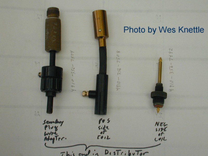

The most simple way to attach test equipment to the M37 water proof electrical system is to purchase a Army electrical system test adapter kit.

Have all of those adapters except for the one that has the Thick yellow line any idea where I can pick that one up at... I'll have to print out those directions too... Thanks Wes...

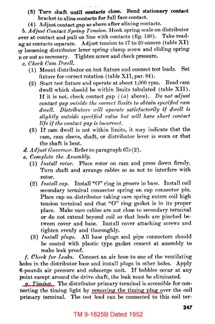

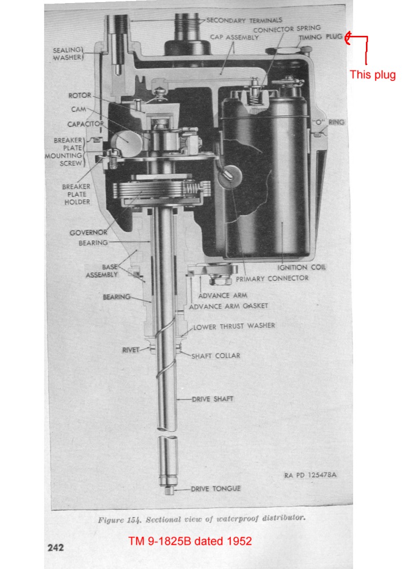

Close but your math is faulty. You have to divide by six since their are six cylinders. Then you have to multiply by two since it's a four cycle engine and each cylinder fires only once per two revolutions. It's a normal electrical meter it reads in Pulses or Cycles Per Second so you also have to multiply by 60 to convert PPS to RPM since they are sixty seconds per minute. However most automotive tachometers have switches to set the number of cylinders and select either 2 or 4 cycles so they do the math for you. I haven't seen a meter that inductively picks up RPM from a spark plug lead. OTOH I haven't bought a new automotive tach for over thirty years!! Is that what the HF meter does or does it use the probes to connect directly to the point side of the coil? I looked the meter up on the HF on-line store but there's no description. I went HF today and was thinking of buying one if that's how they worked but they didn't have any in stock.
I didn't realize that the distributor had port where you could connect directly to the points side of the coil ! Is that shown in ANY of the TMs? I haven't see it in any of mine including the TM for the Autolite ditributor and other items. I looked for my spare distributor today to check for it but I put the thing away where it would be safe and now I can't find it! :-/

[/quote]Is that shown in ANY of the TMs? I haven't see it in any of mine including the TM for the Autolite ditributor and other items.[/quote]
Yep, been there since 1952!
See pages 241, 242 and 247 of TM 9-1825B dated 1952.
Pg 242.JPG (183.27 KiB) Viewed 2841 times
At the top right of the page.
Pg 247.JPG (234.25 KiB) Viewed 2841 times
Bottom of page.

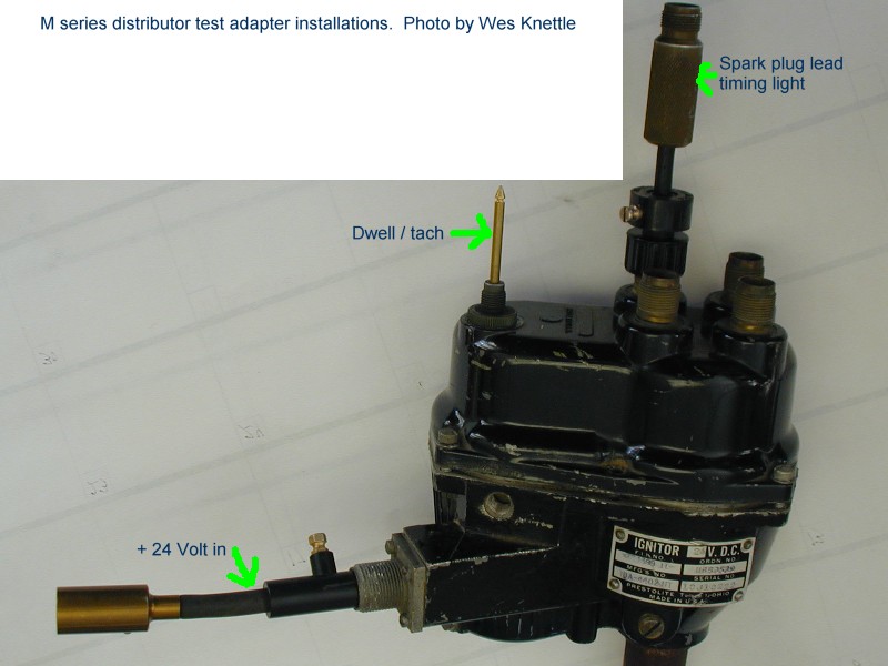

Distr adapters.JPG (66.52 KiB) Viewed 2840 times
Distr side view adapters 2.JPG (77.48 KiB) Viewed 2840 times

Thanks Wes. I reread TM 1825 last night and found that one line at the bottom of page 247 but no other references to the kit! Not even in the references. Which really surprised me. Also no pictures of the kit or any of the adapters.
BTW does your kits say when it was built or by whom? I've seen a similar kit that has clips to hold everything in place. It was made by Allen and their model number is 30-52 and it was procured under a 1967 contract and the kit has the same FSN.

Two things to keep in mind when trying to guess why things were done as they were in those manuals years ago.
1-Those kits were a standard issue tool item in every Army shop.
2-The TM 9-1825B was written for the trained Army mechanic and they only listed special tools in the TM's.
If you get your self a Low Voltage Test Set it will come with instructions that include the use of the adapters. These low voltage test sets were also common issue items in every motor pool. The adapter test lead sets also came with instructions how to use the adpaters like the instruction set I posted above.
The enlisted MOS 63XXX series Training courses covered the use of the test set and the adapter set in great detail. By the time each of these young freshly trained mechanics hit their assigned motor pools they were extremely familiar with these standard tool and test sets. The Army had no reason to repeat those instructions in every vehicle or component specific manual.
Remember that the introduction of M Series in 1948 was primarily to standardize all tactical vehicles. Same wire numbers, same parts, same test equipment and same tools. With all vehicles set up to utilize exactly the same test sets and adapters there was no need to cover the use of those test sets and adapters in every Willys, Dodge, GMC, White, Studabaker, Ford, Auto-Lite, Delco, Bendix and etc manuals.
If you read TM 9-8030 carefully you will see several entries that refer to the necessary adapter from this kit by each adapter's part number and they usually illustrate it being used on the component. IE timing light adapter is mentioned on page 184 and ID'd by PN 17-A-2967-50 and it's installation is illustrated on page 185 fig 94. Also the Test set and adapter kit are explained and illustrated completely on pages 89, 90 &91. Keep in mind this is an Operator's and Organizational Maintenance manual and usually will not address tasks not allowed at the organizational level of maintenance. No single Army manual for the M37 was ever intended to be a single source for all the maintenance operations that can be performed on the M37. It will take folks awhile to get used to the Army's manual system and learn which manual contains which answers. The more you use these manuals the quicker you become familiar with them.

Wes,
Thanks for the illustrations. I would suggest we include this information in the M37 wiki.
