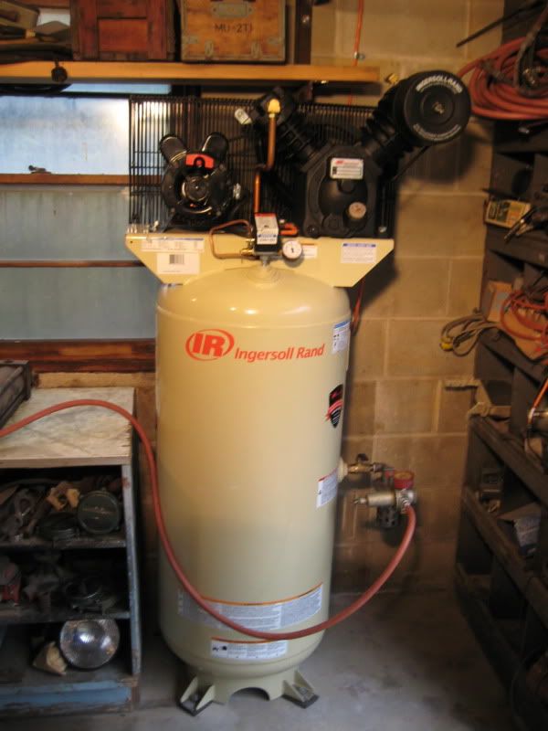

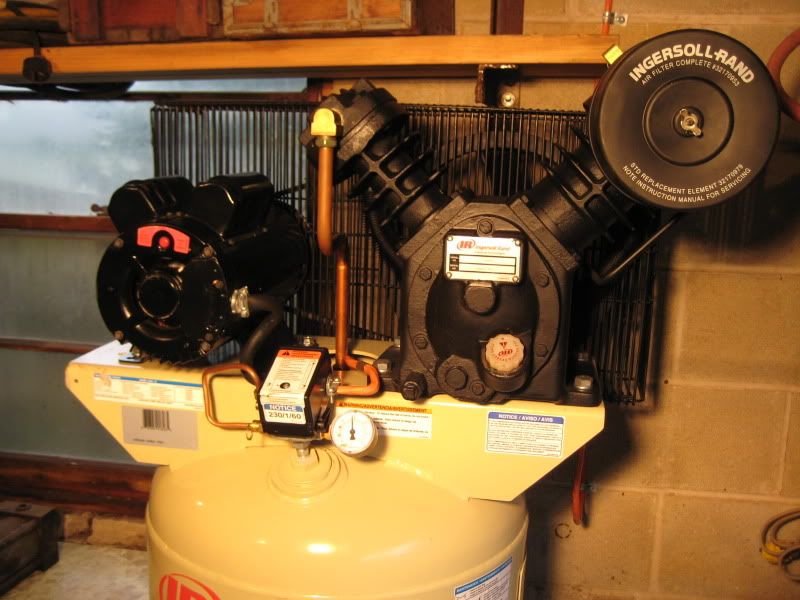

I picked this up Friday at the Sears store in Newark De. it was on sale and had been so for almost a year and was discounted by 1/3 off of the orig. cost of $1299 and no sales tax in Delaware. I have never had a good large compressor and figured it's about time. It's a Ingersol-Rand 2 stage Mod. 2340L5 with a 60 gal. tank and is a 14.7 CFM unit which should made using my sand blaster and air tools a lot faster with no stand-by time needed while the compressor pumps back up to pressure. The down side is I killed my Bosch hammer drill making mounting holes in the 5000 psi concrete floor of my garage so maybe I didn't save as much as I thought I had :cry:
Next I will get a better moisture separator and regulator to wall mount along with a oiler instead if what's connected now, I just wanted to try using it a bit with what I had on hand to make sure it worked OK.

That's a sweet setup! It's nice to do something for yourself once and a while.

Bruce, our local TSC had several IR ones available but none were 2 stage and I wanted the higher psi's for blasting and also the twin V design "looks cool" even though it runs hot enough to leave blisters if it's touched.

That is a fine gift you got yourself. That should be plenty of CFM air to power most anything. Congrats :) How old is your Bosch drill? You should be able to perhaps get some warranty repair on it? Look for a local Bosch service center, you may get lucky. They replaced my buddies work box radio that was 3 years old at n/c.

You beat me to the punch brother! My compressor is still sitting on its skid from when I bought it about a month ago. What did you use to dampen the unit between the unit and the floor? I am still trying to figure out what to use. What kind of mounting bolts did you use? I was going to use 3/8s masonary bolts (those blue ones)......Did you wire the unit yourself?
We had a guy come to the house the other day to give us an estimate on our basement refinishing, and I asked to throw in an est on a 220 line to the garage for the compressor. He came back with something in the $350.00 range. I think I can get that cheaper. You have given me the boost to get my compressor project in gear. Your setup looks real nice.

Nick, I used some anti-vibration industrial machine mounts I was given by a millwright when I worked as a overhead crane inspector at a Beth. Steel plant in Baltimore so that won't be much help but Mc Master-Carr has mounts that might work for you. I have also seen square pieces cut from an old truck tire tread used successfully, just not steel belted one as they are hard to cut and less flexable.
Lifting:
When I got the unit at Sears I ask them to lift it off the skid and lay it on it's side on top of the skid then strapped it in place in my truck bed. When I got home I attached straps to the motor base and hooked a chain hoist to the steel beam in the garage lifted it onto it's feet and set it upright.
Do you want me to come help you get yours set in place since you don't have a lifting beam?
Wiring:
When I built the garage I buried cable to give 100 amp. service and installed a box in the garage which had a unused blank into which I added a 40amp. breaker. The wire used was 8/3 600 volt with ground and was most likely unnecessarely large but while I was doing another project I bought this and just decided to use what I had.
