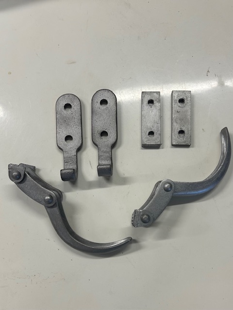

Hold down clamps for the hard top
image0 (1).jpeg (68.13 KiB) Viewed 37880 times
