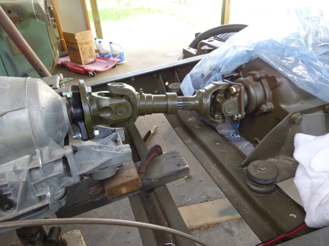

The right color- now if I could just remember where my new splined flange bolts are.
DSC01068 (Small).JPG (117.03 KiB) Viewed 16346 times

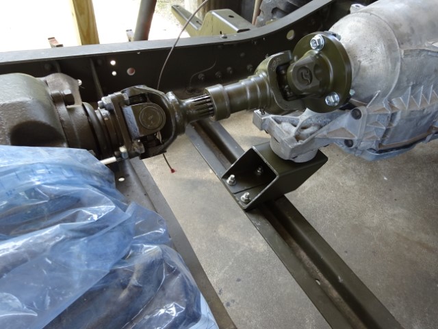

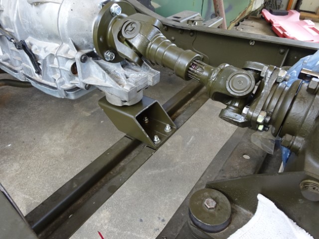

Found my splined bolts and finished the trans mount.
DSC01073 (Small).JPG (117.65 KiB) Viewed 16303 times
Re: 1954 M37 rebuild thread
Just wondering if there's a rubber pad under the tranny end mount? It may be there but I can't tell.
Cal_Gary wrote:Just wondering if there's a rubber pad under the tranny end mount? It may be there but I can't tell.
Inside the round aluminum part there is a rubber isolator -factory Dodge part!

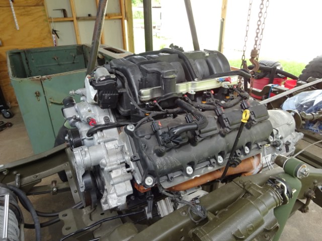

hoist removed and intake manifold back on.
DSC01074 (Small).JPG (127.87 KiB) Viewed 16223 times

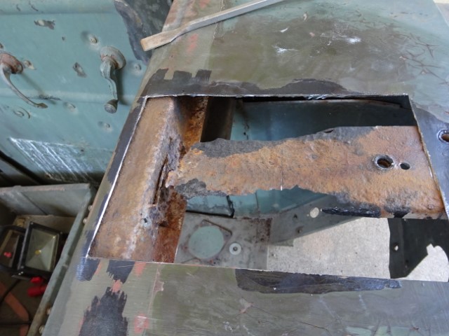

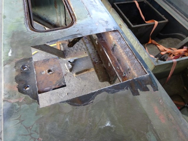

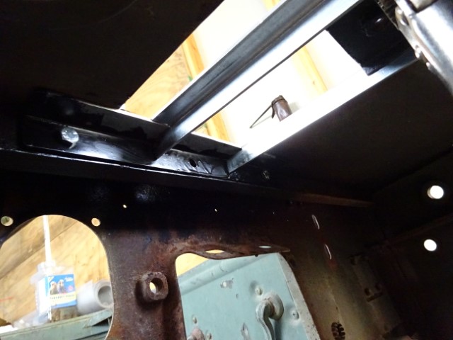

Back to cab repair. there was a spot weld just in front of the back hinge nut that I drilled out. the metal is 18 gauge. now for the rust cleanup and rebuilding the hinge support.
DSC01082 (Small).JPG (110.7 KiB) Viewed 16171 times
DSC01081 (Small).JPG (113.32 KiB) Viewed 16171 times
DSC01080 (Small).JPG (114.34 KiB) Viewed 16171 times

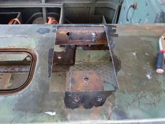

More stuff gone.
DSC01083 (Small).JPG (112.72 KiB) Viewed 16166 times
DSC01084 (Small).JPG (120.33 KiB) Viewed 16166 times

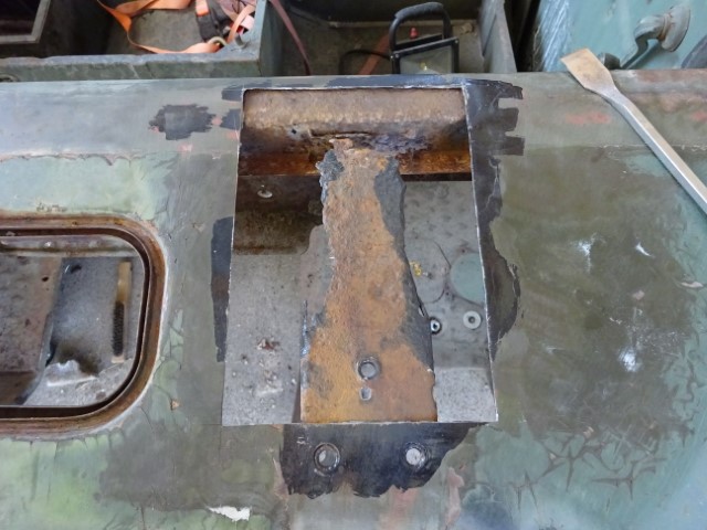

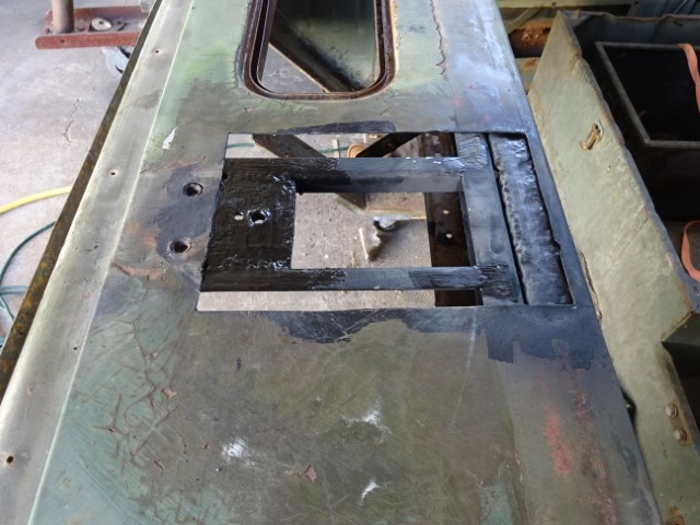

ready to start welding.
DSC01085 (Small).JPG (114.06 KiB) Viewed 16129 times
DSC01086 (Small).JPG (101.28 KiB) Viewed 16129 times
DSC01087 (Small).JPG (96.45 KiB) Viewed 16129 times

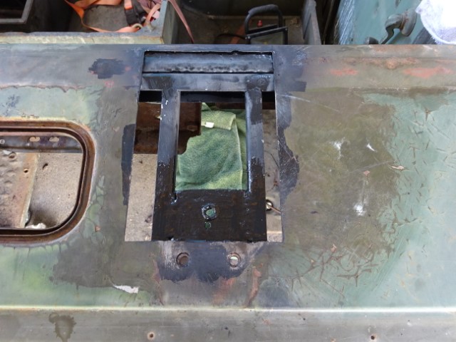

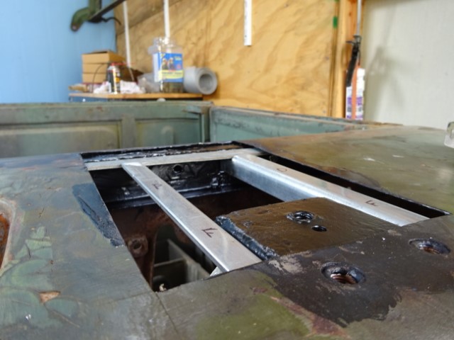

in permanent
DSC01088 (Small).JPG (114.05 KiB) Viewed 16114 times
DSC01089 (Small).JPG (118.23 KiB) Viewed 16114 times

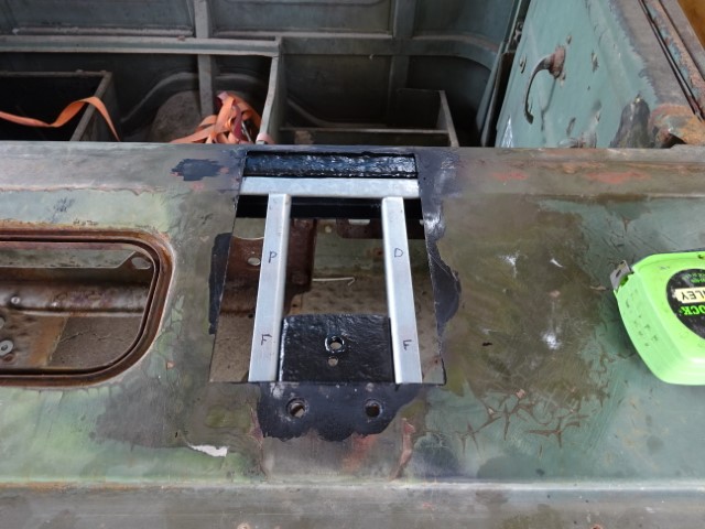

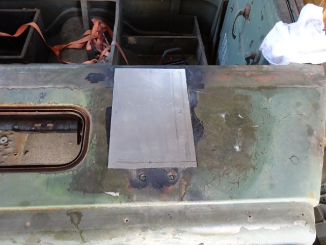

Now the really hard part! (for me anyway). Got to practice first- a lot, no second chances.
DSC01090 (Small).JPG (104.4 KiB) Viewed 16113 times
rickf
Posts: 437
Post by rickf »
Clean the original piece to shiny metal, clean any coating off of your new piece using a scotchbrite pad. Then be sure there is a gap in the metal all the way around the same as the thickness of the metal. Does not have to be exact but no tighter. If it is tight together yo will have massive distortion. When you weld do a short section, very short. Then move to another area and do a short section, another area, short section. then back to your first area, short section and move. This is called backstepping and keeps from building up too much heat in the surrounding metal. It will prevent warping and also help with preventing blowthrough.
These clamps help a lot with spacing the panel for welding and also aligning it.
https://www.eastwood.com/intergrip-pane ... X4QAvD_BwE
Thanks for the tips, I am not the best welder in the world.
rickf
Posts: 437
Post by rickf »
I have been welding for most of my 65 years and I am far from the best welder. I have done a lot of body welding though so I have made most of the mistakes and found a lot of the solutions. there is a web site I recommend for anyone who is not sure of their welding skills, I have learned a lot from it on top of what I knew over the years.
https://www.youtube.com/channel/UCqq70A ... ApS_m_6mPw
