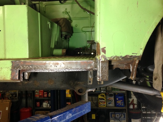

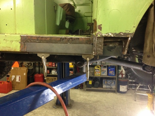

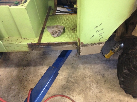

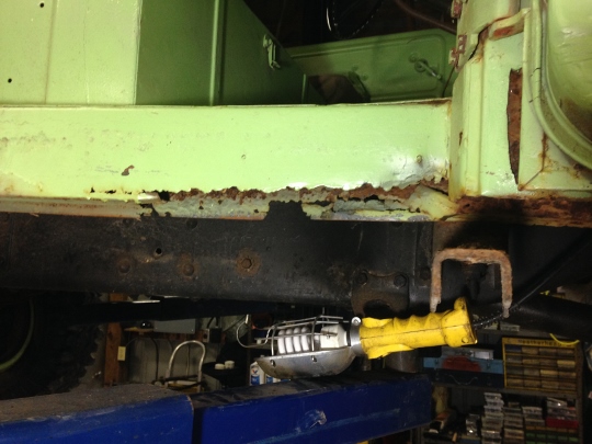

Got to working on passenger side rocker panel. Little rust, not horrible. I cut out the outside and inside parts of the rocker panel as well as the bottom part of the cowl. Got it all wire wheeled/needle scaled and sanded. In the last picture I have the back or inside piece all cut and fitted and tac'd in place. The outer half is just clamped in place. To finish this section will need 3 more pieces made. But all small. Ive been thinking how to make the outer part of the lower cowl. Its curved as well as a 90 degree lip on it. There was an inside hole at the back of the lower cowl that I am not going to put back. In the pic its marked with a sharpie but its not there. However on the bottom part of the cowl, im going to make a much larger hole than was there. Easy to wash out, not that this will be a mudding truck anyway. Also will prime the inside of all these pieces before welding up.
The steel in these old trucks amazes me. You can have a rusty section and just past the edges is good enough metal to weld to. Like new thickness. Its like it doesn't want to rust. Better steel in those days I think.

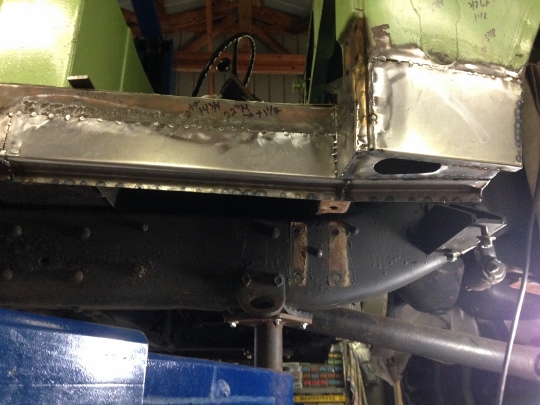

Moved along a little more. Got all this stuff tacked in place. believe it or not there is 8 pieces in all that repair. Got one small spot at top to repair then will move down the right side to repair the storage door. Thinking will work around the truck back to drivers side.

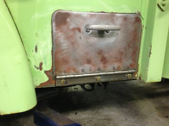

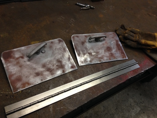

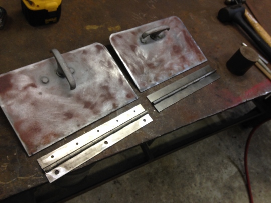

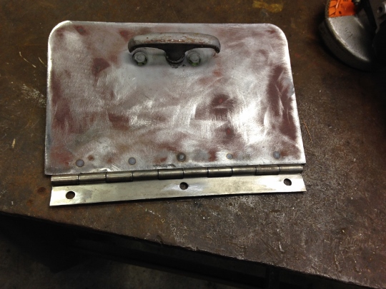

Finally got back to work on the M37. Both storage area door hinges were rusted in a pile and both doors fell off. I sanded / glass beaded the old doors and ground off rusted hinges. I couldn't find any piano hinge locally that was right size so I ordered from Mcmaster Carr. If anybody needs it, the part # I used is 15665A546 , Its a bare hinge [no holes] 2"x24" long, Knuckles are 1" wide and pin diameter is 3/16" about $5.00 plus freight. I just cut to length, bored holes in original places. Then bored holes so could Weld to door. Turned out pretty good and works nice now.

Last pic, installed temporarily until I'm ready to prime and paint

Very nice how the doors turned out.
Re: 1953 M37
Nice job! Those would be very hard to tell from originals.
