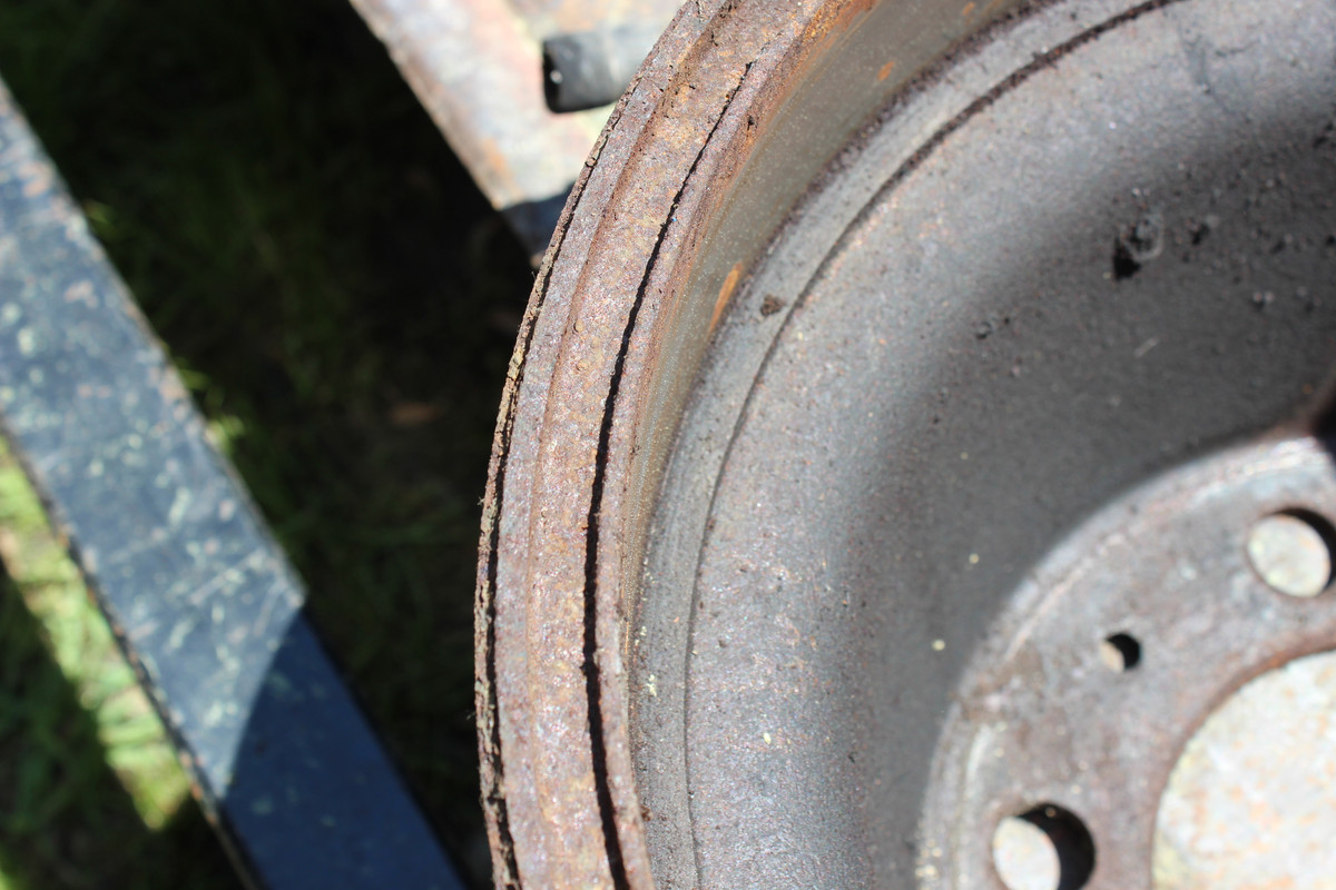

As promised here are the pics of the brake disassembly. It is an interesting compilation. The passenger side had old shoes but it has an outer hub seal with short axle studs, the drivers side had brand new shoes with no outer hub seal and longer axle studs. You can see the pics of the drums and how thin they are. And remember when I said I squeezed the beast in there? You can see I was not kidding! Anybody need a 350 small block? They are all four bolt main engines.

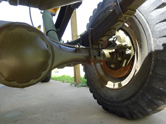

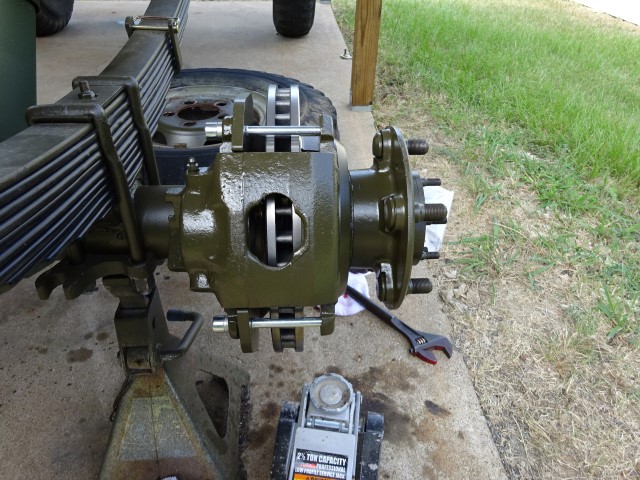

Progress, I had to call Charles Talbert to ask how the hell to get the brake backing plates of the rear axle. What a pain in the arse!!! Won't be using that backing plate again! Going to try to save the other side but man, those rivets were never planned to come out in a million years.
Pictured below is one of the disc setups on the truck but it is going to have to come back off to be derusted and painted. I am going to make up all new lines and I am pretty sure I am going to run a dual master cylinder and power brakes. I am going with the disc brakes for safety so why stay with a singe stage master cylinder? Kind of defeats the purpose.

here is a pic of my lines.
rickf
Posts: 437
Re: Another green thing to work on, 53 M37
Post by rickf »
Thanks for that picture, I sort of figured my line was not placed on the caliper correctly. These brakes were never used so the parts are just put together for transport. They weren't even very rusty til they sat out under a tarp all winter. in the process now of cleaning and painting. Did get the other side backing plate off with a bit less drama but it was still a royal pain. How many times have you had a 1/2" drill bit shatter into four pieces?! YEE-HAAAA

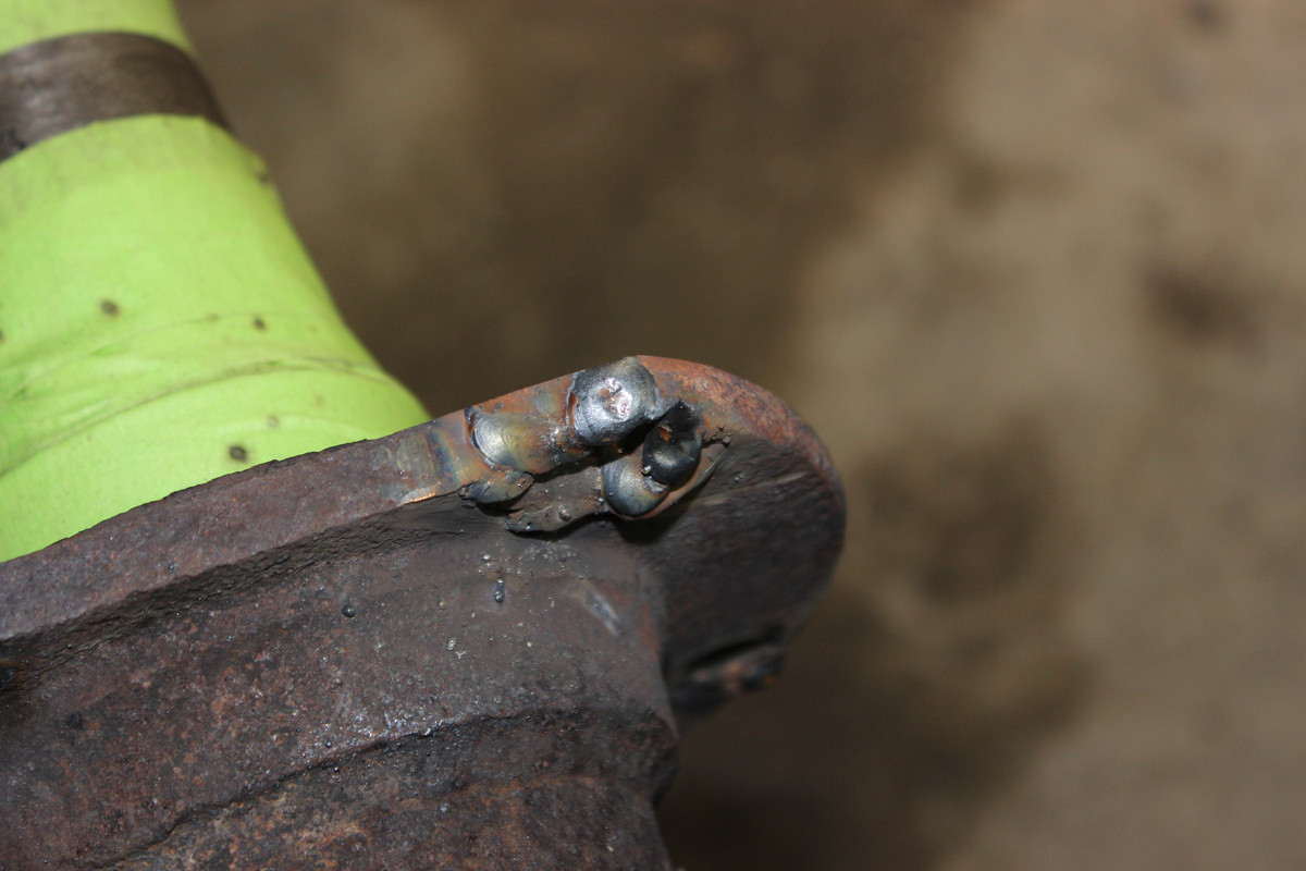

This is for anyone who finds this and is contemplating putting on disc brakes. When it comes tome to remove the backing plates on the rear axle you are going to have to drill the rivets. Do not try to torch them because back when they put these rivets in they KNEW how to put rivets in!!!! Generally when you torch cut off a rivet head there is a microscopic gap between the rivet and the housing and that is all that is needed for the torch to cut the rivet but not the housing. These rivets are so tight that the rivet head and the housing are one. You WILL cut into the housing! On top of that even with the head cut off the rivet body id still not going to come out. Here are some pics of the one side that I tried to torch the rivets off, unsuccessfully. I ended up having to weld up the gouges and redrill the holes in the housing so that the bolts would seat evenly and solid. The weld spots on the face of the housing are where I drilled off center. The black paint hides the grinding involved in getting all the welds perfectly flush with the original flange. Should have taken the pics before painting.

I chisel the heads off and drive out with flat tip punch. I use pneumatic tools for both procedures.
rickf
Posts: 437
Post by rickf »
I tried that before the torch, I was hitting the punch full swing with a 3 lb. sledge! Then I had an air hammer on it with a cut off toll I use for driving, Nada. If you have gotten them out of a M37 this way then you were lucky. That is how I get them out of later vehicles with no problems.
Looks like a job well done, I was really lucky, I was able to drive mine out. I might not have been the first to do so?
