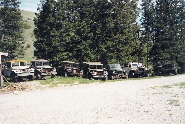

Re: Another green thing to work on, 53 M37
The lighter one I bought from a guy in Wisconsin, named Jerry, he had about a half dozen trucks, both M's and PW's, he has since passed away and John at Midwest Mil bought his entire fleet! Originally I bought the frame to replace mine, then I figured out how to repair it.
Jerrys Fleet of Dodge M37s Power Wagons.jpg (77.85 KiB) Viewed 28689 times
rickf
Posts: 437
Post by rickf »
If you are talking about the one on the far left and that frame had just surface rust on it then it sounds like the same one. Man, that would be weird! And a lot of traveling for the frame!

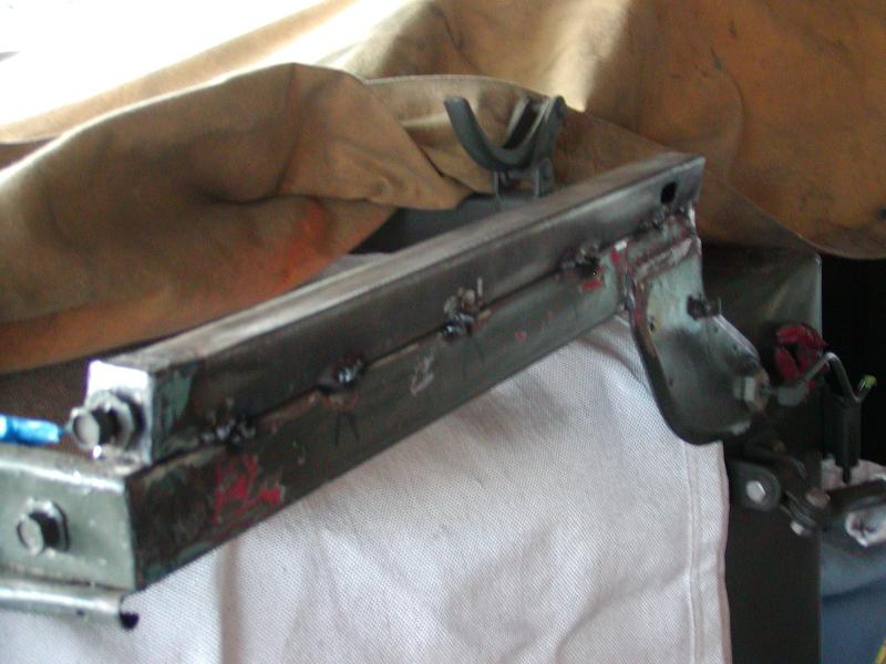

That looks serviceable, the crap that you are leaving behind might come back to bite you, that is whatz called creeping death. (you might out last it) My cowl was in great shape, the channel that the vac lines rides in was toast, a guy at work made me a brand new one.
Vac Channel Weld Complete.jpg (54.19 KiB) Viewed 28665 times

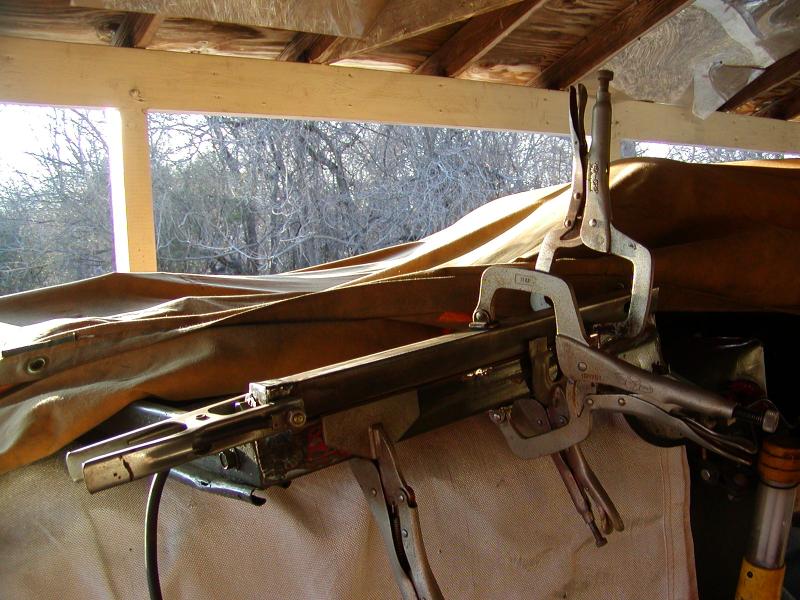

Here's another shot of the same channel clamped up before welding.
