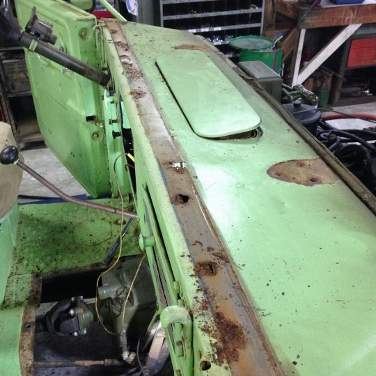

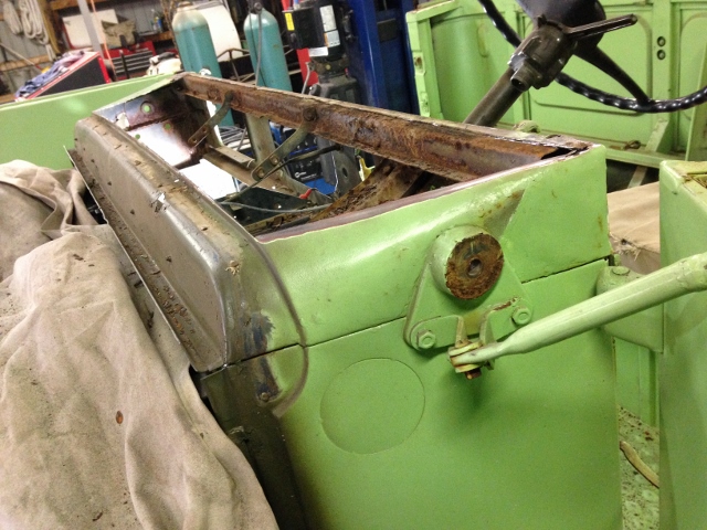

hey everyone. haven't posted in awhile, have been busy. But progress on the old girl has been moving forward. Got the top off ok and started on windshield. Found rust under windshield as well as around cowl area. So cut it all out. Here I made some cross pieces for the hinges to bolt to that will be under the cowl.

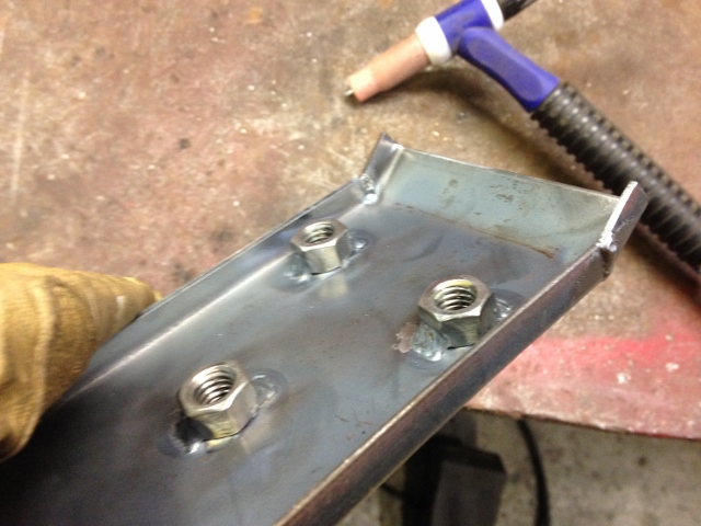

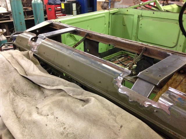

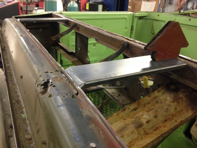

Here I made the hinge brackets with captive nuts. After tacking to cowl using the old rusty part to establish height. I cut out the rusty part

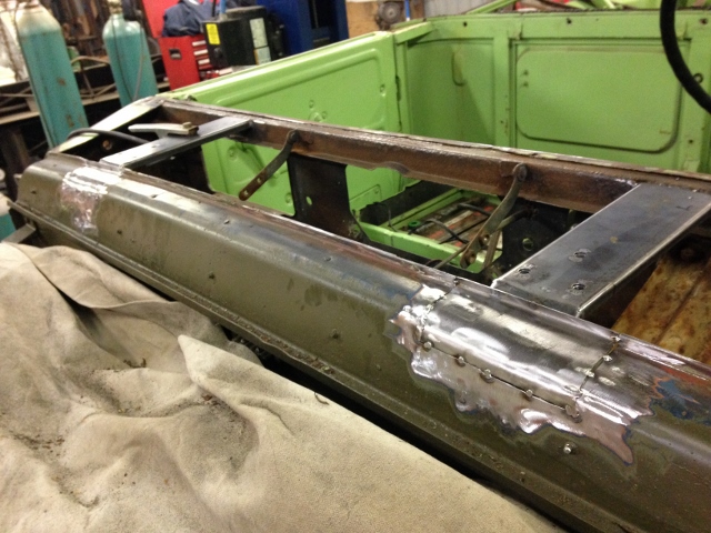

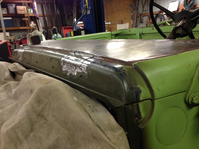

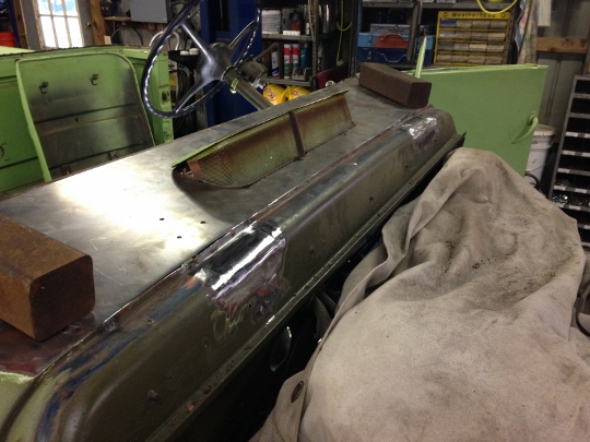

I made new pieces for the front of cowl edge and tacked in place. Also cut out sheet metal to make the new cowl top. Just sitting on there to test fit. Still need to cut out for vent and drill holes for hinges. I think I am also going to add a couple small pieces below the end edge seems. As well as on either side of cowl vent to stiffing cowl/

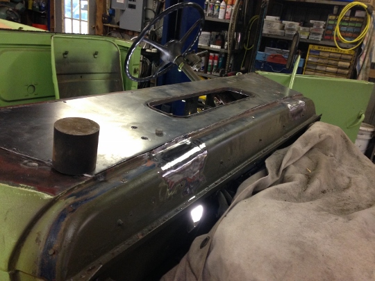

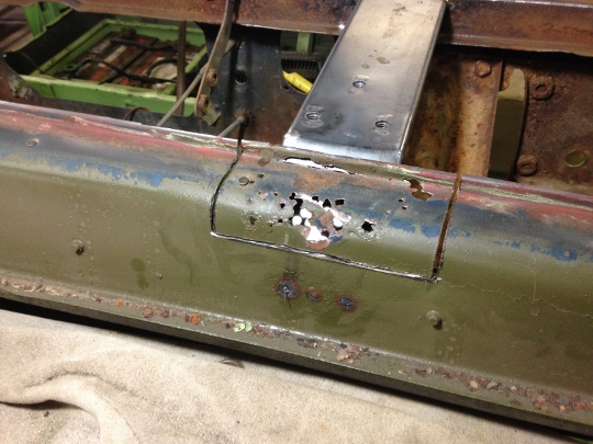

Few more pics. Worked on the cowl more today and made good head way. Added support braces at each end of new panel. Made up new new opening for cowl vent. Bolted vent to hinges to see if worked and worked great. Primed everything under cowl and tomorrow hope to weld new cowl panel in place. After that plan to move down the sides of each side of cowl and repair whats need and move toward the rear. Not much work needed on the rear bed, so hopefully go quicker. Those solid pieces of square stock and round stock in the pics are great for holding pieces in place. I have a bunch of then and use for everything.

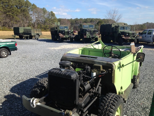

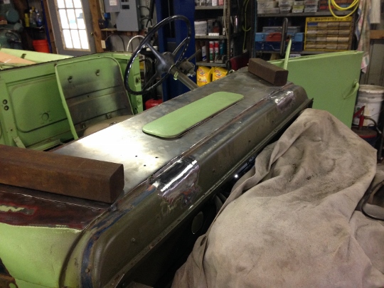

Worked a bit more today. Got the cowl all welded in and the vent glass beaded and primed. It did get to see the light of day and took out and ran around field some. Plan on work ing on right side of cowl next. 2 spots that need cutting out and replaced. driver side is fine with only a dent. Here she sits outside, enjoying some sun. Wont be long and it can go play with its bigger brothers in the back ground.
