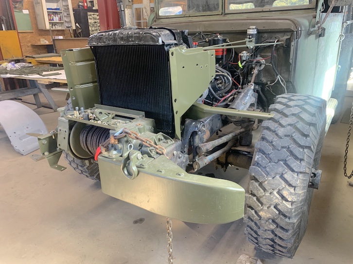

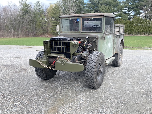

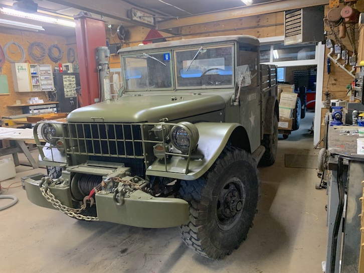

Made progress last week in the recovery from the accident last fall. Tim Holloway has been priming and painting the various parts, and keeping me from getting in to trouble as I try to help out with shot blasting some of the smaller pieces.
On Tuesday, we did a test fit of the winch and front bumpers and installed a couple other pieces. Everything fit, so we removed the right front bumper for priming and painting. (It had been badly mangled in the accident, and "pursuaded" back into by a local fabrication shop.)
Later in the week, Tim addressed a a couple of minor oil leaks, reinstalled the bumper and a few other parts, and found and fixed an air leak which had been requiring partial choke to keep the engine running.
We're getting there! It won't be long before Brutus is back on the road.

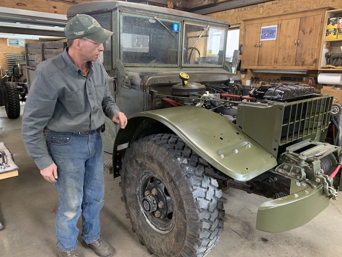

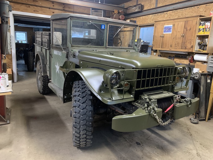

Spent the day at Distinctive Restoration helping Tim Holloway put parts back on Brutus. He's back together again!
I still need to paint some bolt heads, and Tim diagnosed a problem that causes the horn to blow continuously any time the power is turned on (need to replace a broken part), but Brutus has his new clothes on!
My theme song for the day: Darryl Hall & John Oates - Back Together Again (1976)
https://youtu.be/yNk6ErNl89s?t=30
Right fender installed. Tim contemplating the next move:

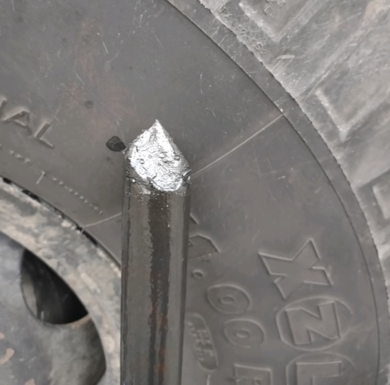

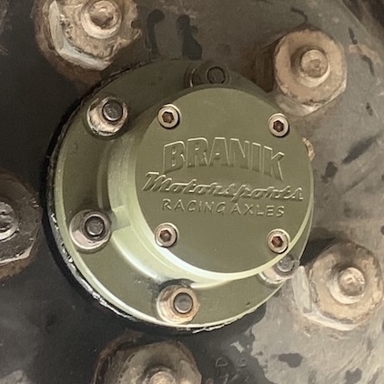

In Nov or Dec 2022, I did end up having to replace a rear axle that snapped while pulling slowly away from a stoplight. I'm guessing it had been on it's way out for quite a while. The break was rather unusual looking: It looked a bit like a beaver-chewed sapling.
Axle Beavers sm.jpg (69 KiB) Viewed 10134 times
Tim Holloway replaced both rear axles with hardened axles from VPW. So hopefully I won't have that issue again.
