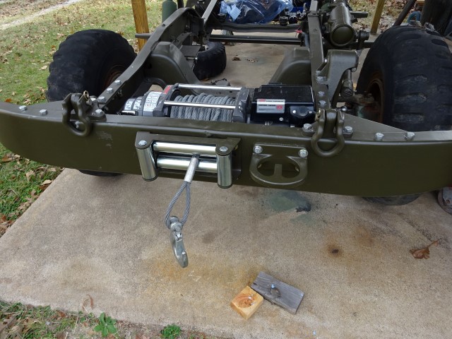

Post by F18hornetm »
Very nice looking. I do like the welds better. Looks great!!!
I have a warn 18,000 lb 24 electric winch I bought to make an A-frame on my M931. Since then bought a M543A2 so no need. Thought might sell but you just gave me a great idea to install it on our M37. Thanks for pictures
F18hornetm
Posts: 248
Re: My WOW is becoming a W/eW
Really like how you made it fit through the front bumper instead of a sorta 2 piece bumper. Looks great.
I'm sure you don't plan on pulling to its max often as i would worry about the bumper bending where its mounted. As you know most winches are mounted in frame extensions and not directly to the bumper alone. Having said that, for normal use will probably be great and looks cool.

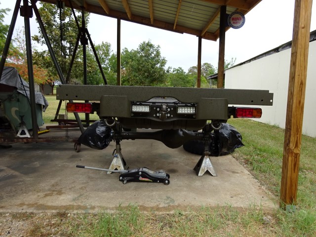

Another,
DSC00983 (Small).JPG (145.57 KiB) Viewed 39539 times
rickf
Posts: 437
Re: What do you think?
Post by rickf »
OK, You now have the extreme front and extreme rear taken care of. Now all you have to do is fill in the middle!

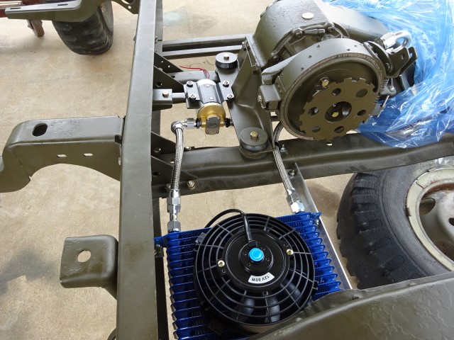

F18hornetm wrote:[ Plus maybe A/C, cruise, powersteering etc :D

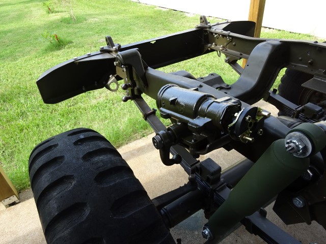

In the works,,
20160628_151112 (Small).jpg (210.3 KiB) Viewed 39447 times
F18hornetm
Posts: 248
Very cool. What motor is that? Cant see enough in picture to tell. GM steering gear box?
F18hornetm wrote:Very cool. What motor is that? Cant see enough in picture to tell. GM steering gear box?
It is a 5.7 Hemi. The gearbox is a '76 Dodge truck-reverse rotation.
Better pic,
DSC00881 (Small).JPG (136.4 KiB) Viewed 39435 times
F18hornetm
Posts: 248
Very nice , thanks
F18hornetm wrote:Really like how you made it fit through the front bumper instead of a sorta 2 piece bumper. Looks great.
I made a 1/4" plate that fits snugly in the bumper- see previous pics- this bolts to the frame mounts for the bumper and the bumper too. Very sturdy. The top inner bolt for the lift shackle bolts thru the 1/4" plate, you can see this if you study the bolt holes in my mounting plate. The two bolt holes on the bottom at each end attach using the two bumper frame mount bolts at each end. All bolts are grade 8.
F18hornetm
Posts: 248
Oh I see it now , had to go back to first pics. Looks great!! Also the frame is all nice and clean with new fasteners. Nice job.
Winch is done.
DSC00994 (Small).JPG (137.05 KiB) Viewed 39399 times
Looks good. Nice work!

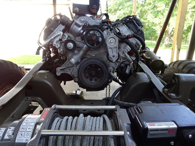

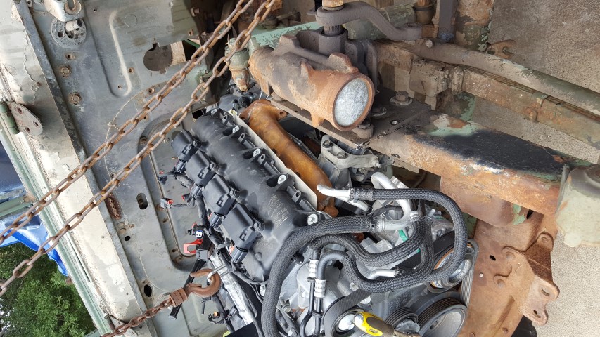

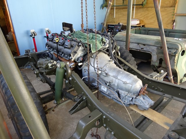

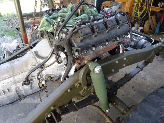

Re: 1954 M37 rebuild thread
Got the engine/trans in.
