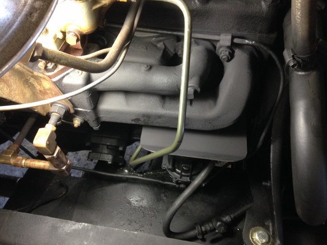

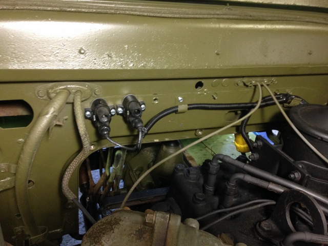

Made a heat shield for the fuel pump today from 14ga sheet metal. Also re-routed and made new fuel line further away from exhaust. Mounted 2 new breakers on firewall inside engine compartment instead of a single one under dash as original.

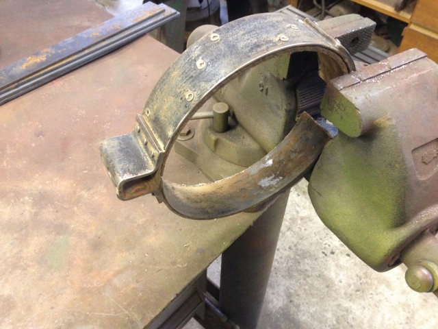

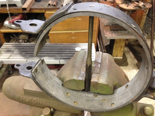

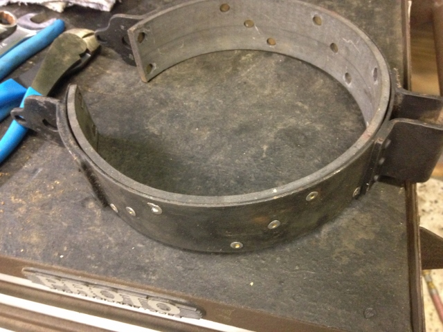

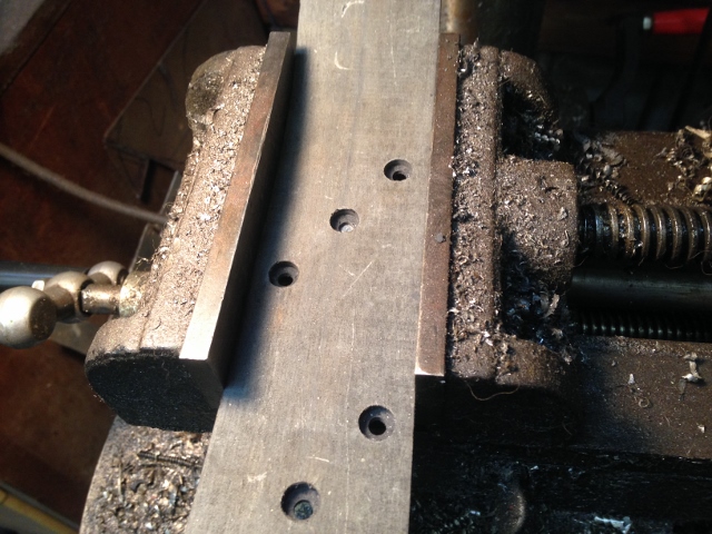

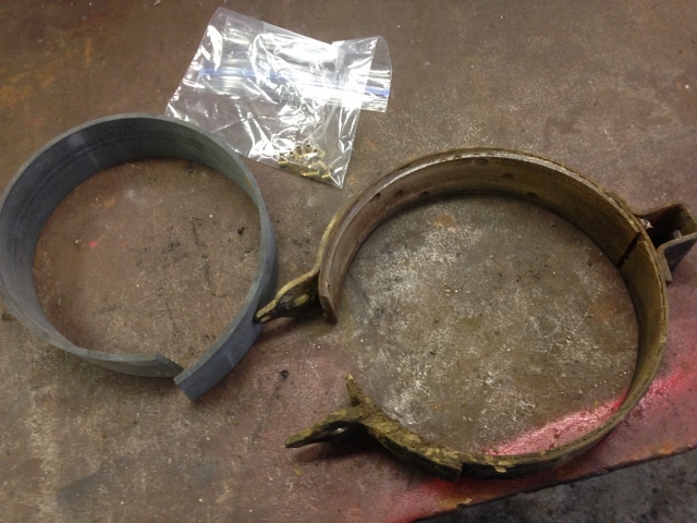

Worked on re-lining parking brake today. Got new linings and rivets. Linings did not come drilled for rivets so came up with a way for that. Cleaned off old lining and glass beaded/painted steel band. Rivets need to be countersunk. Clamped linings to shoe and drilled hole size of rivet through metal shoe into linings. Then put linings on drill press, and used drill bit the size of the head of the rivet to counter sink. Clamped lining in drill press and inserted a piece of square tubing under the lining, but narrower than the lining. This allowed the clamp to hold the lining and the square tubing created a consistent height. Drilled half the thickness of the lining for rivet head. Found best way to set rivets was clamp a long punch in the vise the size of the rivet head. Then using ball peen hammer set the rivets. Went pretty easy and will install band back on drum tomorrow

Couple more pictures on in the drill press vise and setting the rivets

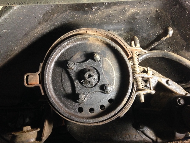

Got a little more done today. Installed the parking brake band and adjusted up. Had to make one of the adjustment screws as old was wore out and found a compression spring that would work under the anchor bolt. Had to make that too as old bolt was wore out and loose, so drilled the head of a new bolt for the safety wire.

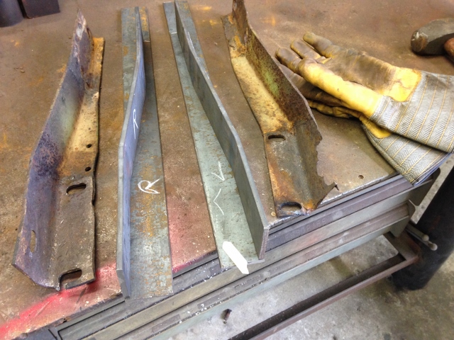

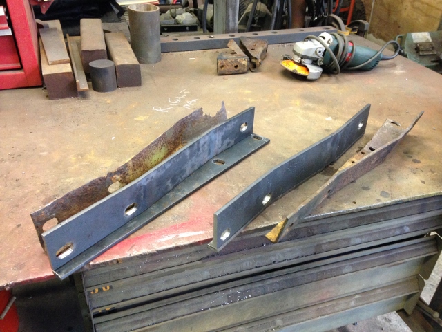

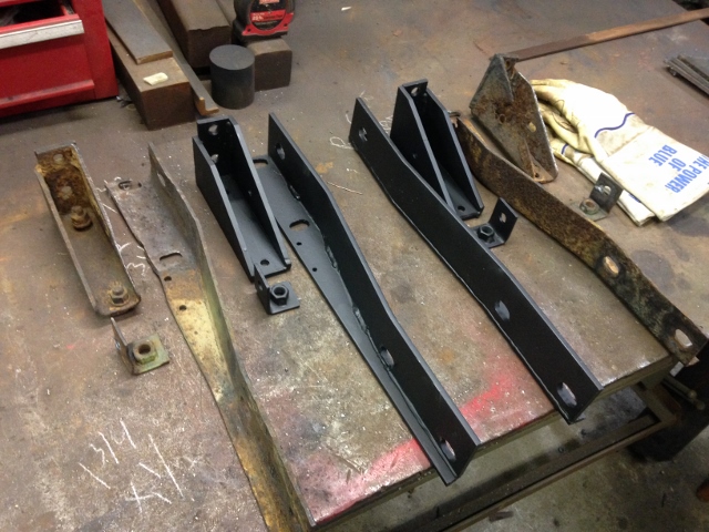

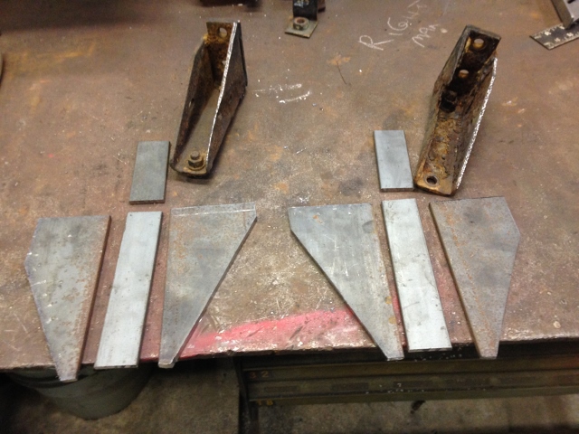

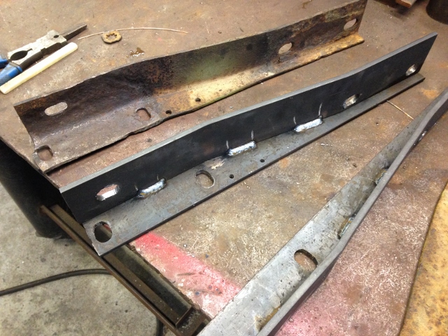

Made the front fender rear mounts. The long ones. Will work on the fender mount to frame bracket tomorrow maybe. Little heavier than what is needed. I measured the old brackets at 3/16" but I had some 1/4" in the right width. Could have used 1/8" probably. I bent the first piece to match the contour of the old bracket. Then laid on top of flat bar and traced. Cut out with plasma cutter. Then I cut all the all the slots for bolts holes and then welded the two pieces together. Where the seam is will rust so will fill in with seam sealer before painting. No real reason to weld the whole length.

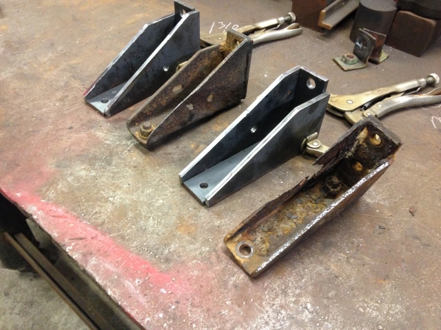

Moved a little further along today. Made the front fender rear mount, frame brackets today and the inner fender tabs and got all painted up.

Very nice looking fab job on the brackets.
