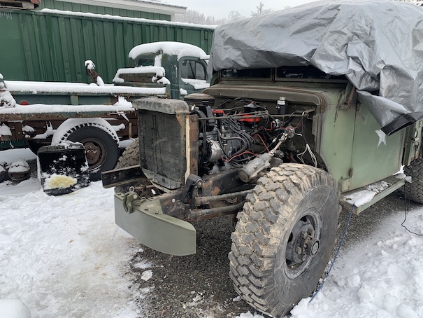

Here's a picture from back on December 1, 2021, when I rolled the tarp back off of Brutus and removed the damaged parts. Tim Holloway had an old radiator with a few leaks, but we figured it would hold coolant long enough to drive back home and put him in the basement shop. Here is a shot of that:

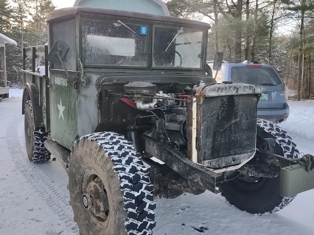

I drove it home that same day. The drive was a little more eventful than I had envisioned. I failed to realize that even if the leak was slow enough to allow us to make it home on one fill of coolant, with none of the sheet metal around the engine, the radiator fan blew all of the leaking coolant back on to the windshield. My windshield seals are just about non-existent, so some of it ended up inside the cab. In addition, about half way home, the driver's windshield wiper stopped working. Here's a shot of Brutus sitting in my driveway. The wetness you see on the windshield is not melted snow, it coolant.

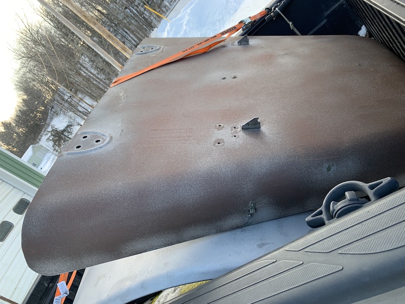

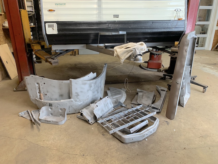

Yesterday I picked up the good parts I had removed from the front end, along with the used replacement parts Tim Holloway had. This morning, I dropped them off at a local auto/equipment repair shop for shot blasting. I picked them up this afternoon and brought them back to Tim's shop.
Still a bit of the old red primer on the hood, since we had asked the shotblaster to go easy on the hood:
Hood shotblasted.jpeg (168.88 KiB) Viewed 7030 times
Pile of parts, shotblasted

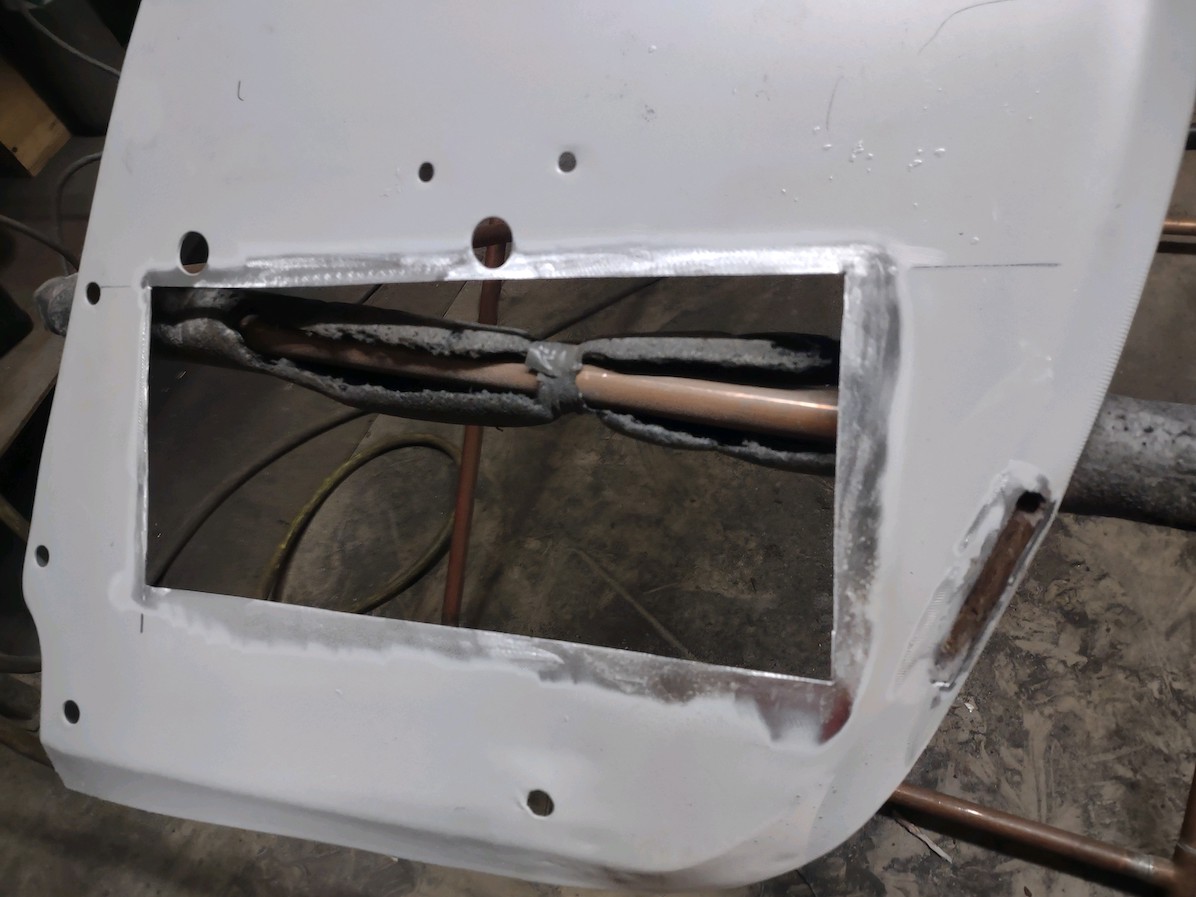

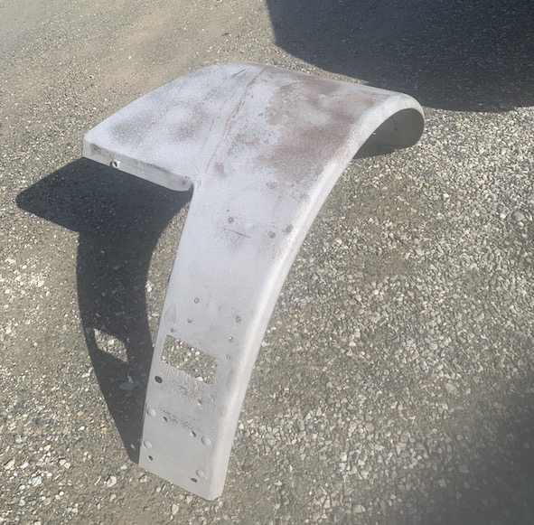

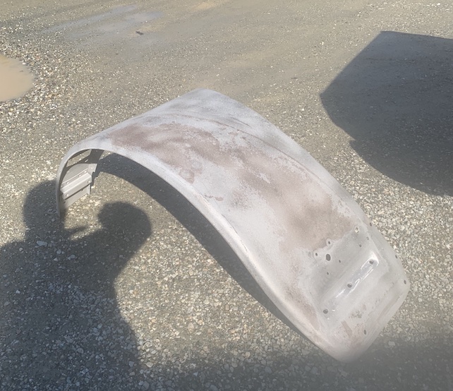

Our planned replacement fender had some damage that was more trouble than it was worth to repair. Tim ended up combining pieces from two fenders that were damaged in different areas to make one good one. He patched in the headlight mount area and the rear section from one fender into the body of another.

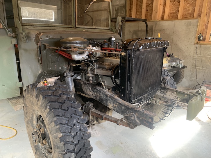

Installed the rebuilt radiator earlier this week and filled it with coolant. I got a bit of a scare, since it appeared there was a slow leak where the water pump mounted to the engine. I thought I had messed something up when putting the water pump back together and mounting it to the engine. I decided to start it up anyway, since the engine had not been run in almost 4 months. The engine ran fine, and the leak increase from a rapid drip to a small constant stream. The upside is that it was leaking badly enough for me to spot the source: I had forgotten to tighten one of the hose clamps on that short length of hose that goes from the water pump to the top of the engine. I tightened that up and took it for a test drive.

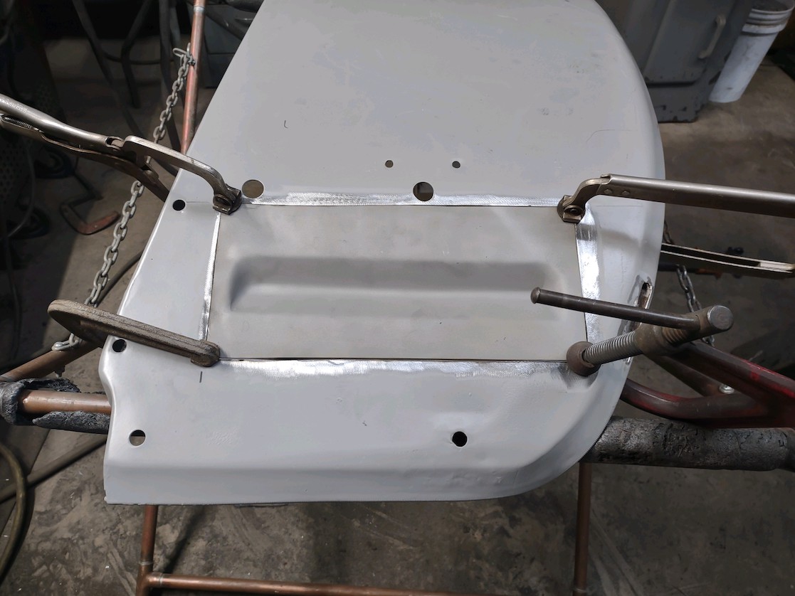

Tim Holloway installing one of Charles Talbert's fender patch kits for the headlight area. This fender was not damaged in the accident, but decided to remove and sandblast it since the whole front end is getting repainted. The headlight area had some rust, so that was cut out and the patch kit installed.

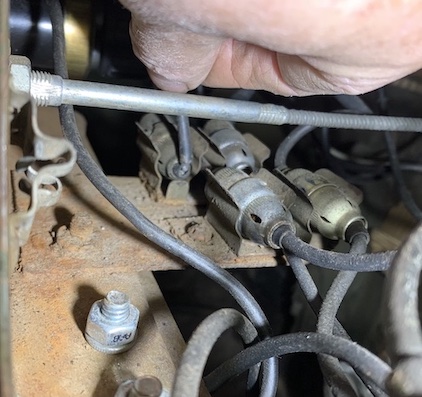

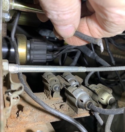

Back a couple of weeks ago when I first fired Brutus back up and found the coolant leak (loose hose clamp), I decided to take him for a short run down our 1 mile dead end dirt road to pick up our mail at the end of the road. I had to leave a bit of choke in to get the engine to run smoothly (I'll have to check that later). The engine ran well, but when I got to the end of the road and was turning around to come back, I heard an electric zap, saw a wisp of smoke come out from behind the dash, and the truck died. It would turn over, but not restart. I got my wife and her friend to help me tow it home.
When troubleshooting, I could hear my electric fuel pump when the ignition switch was turned on, so I knew the switch was working. I measured 24+ volts at the distributor end of the wire from the ignition switch. I was dreading finding a bad coil or fried electronic ignition. However, I remembered that the sound and wisp of smoke was inside the cab, so I looked under the panel and behind the instrument cluster. I noticed a wire coming out of the connector from the ignition switch was bent sharply and appeared to have some insulation missing right were it exited the connector. I touched that wire, and it popped right out:
broken ignition wire 1.jpeg (75.81 KiB) Viewed 6873 times
broken ignition wire 2.jpeg (65.82 KiB) Viewed 6873 times
Replaced the wire with one a bit longer, so I could reroute it without the sharp bend, and the truck fired up normally. Apparently, the loose wire was making just enough of a connection to show up on the voltmeter, but not enough to supply the amperage necessary to run the ignition system.

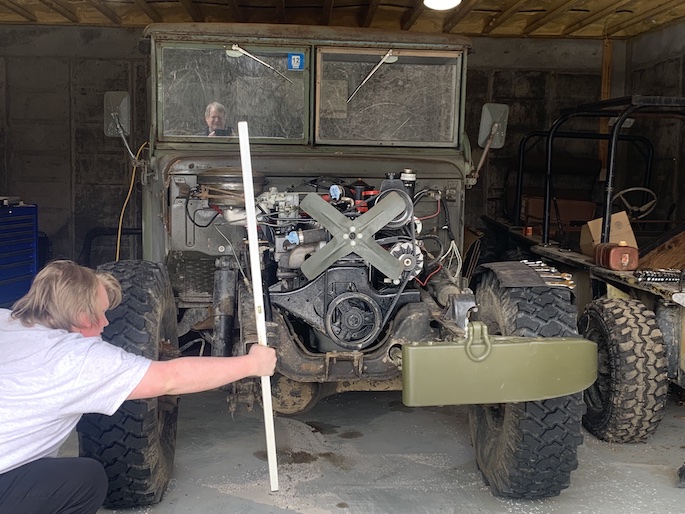

I have an appointment on April 6 at a local auto repair shop to get the slight twist in the end of the right frame rail straightened out, and pull out a slight buckle where the hood hinge bolted on to the area just in front of the cab. Tim figures we could do it ourselves with a bit of grunting and cussing, but these guys have all the equipment to do that sort of thing.
In this picture, the straightedge is being held against the frame rail. It should be pointed straight up and down. Once that work is done, we should be ready to start putting the painted and shot-blasted pieces back on. (Thanks to my son in the photo for the assistance.)

Re: M37 "Brutus"
Good grief John, somebody drop a house on that side? That fix should help with your bolt-hole alignment.
