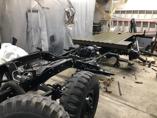

Since it’s such a prominent piece, I’m making it look nice.

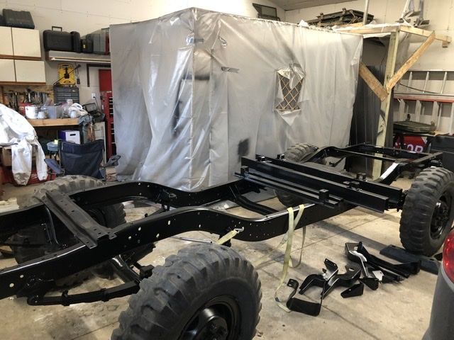

Picked up the frame today! The old girl didn’t want to roll too well, some thing up with the front axle. Ended up ‘driving’ it with the front input flange, a quarter turn at a time.

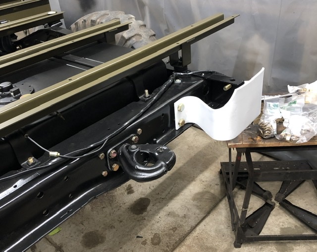

The bumperettes I took off were white, and I like the look.

I like that, reminds me the white tipped front bumpers from Nam.

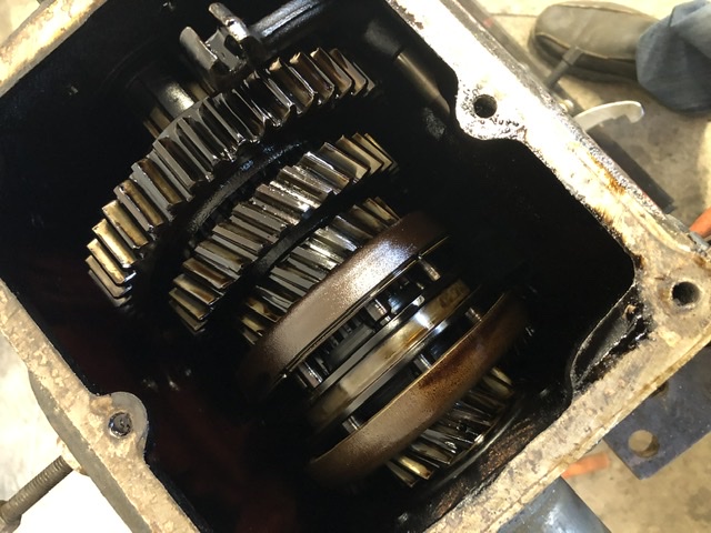

Going to replace the leaking output seal but I can’t see a reason to go in further (?). The lower gears look good too.

Re: Grandpa’s M37
That gear set sure looks nice! I don't think I'd go deeper on it myself.

Since water will collect at the bottom, I would take one of the side plates off and have good look around for any dark or rusty spots on the cluster gear.
My cluster gear was not terrible but my lower bearings had a fair amount of rust on them.

Great advice, Sturmtyger I will do that. Thank you.

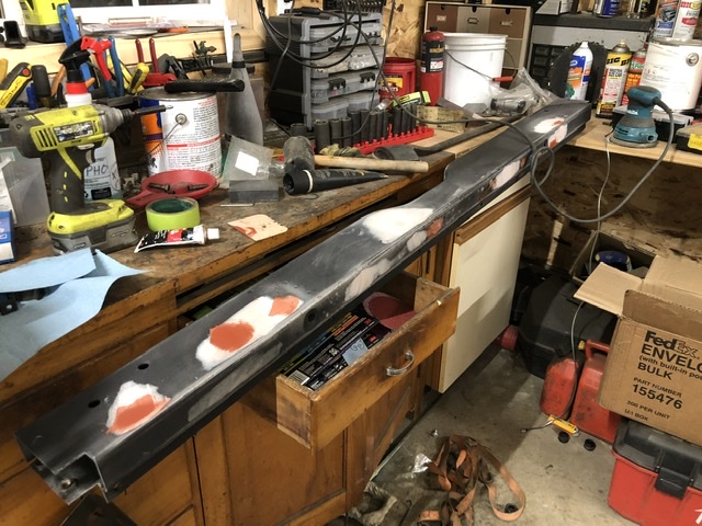

greeno
Posts: 238
Location: Monticello, MN
Re: Grandpa’s M37
Post by greeno »
“Just do one little thing”
M37
YEAR: 1954
