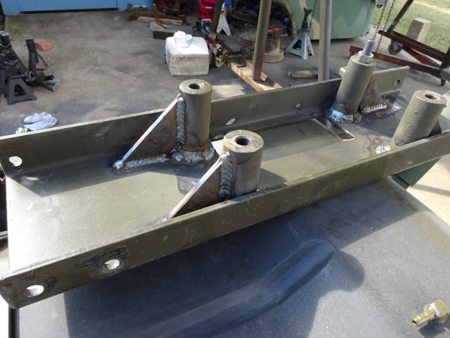

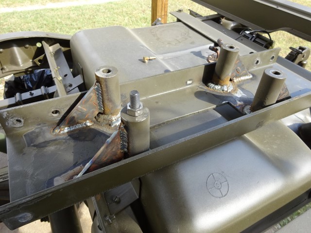

You may want to reweld those posts that the winch is going to be mounted on and use a LOT more heat! If the winch pulls to the side they will probably come right off.
Re: My WOW is becoming a W/eW
My welding skills are not great. But they are just standoffs- the winch will be bolted with hi strength bolts. I am toying with some gussets on the outer sides of the standoffs. My little welder works well with 1/4" plate but I couldn't do well with this stuff. The winch is a 12000 lb Warn winch from a late model Power Wagon- so the Dodge markings.
rickf
Posts: 437
Post by rickf »
If you are using a MIG then you are going to need 160-180 amp with .035 wire or you could get by with 160 amp if you went with flux core wire and DC - or "straight polarity". The other option is to use 100% Co2 in your MIG for more penetration. Just some ideas, I would hate to see those standoffs break off and then break the aluminum housing on the winch. The gussets are a good idea but you will still need more welding heat.
rickf wrote:If you are using a MIG then you are going to need 160-180 amp with .035 wire or you could get by with 160 amp if you went with flux core wire and DC - or "straight polarity". The other option is to use 100% Co2 in your MIG for more penetration. Just some ideas, I would hate to see those standoffs break off and then break the aluminum housing on the winch. The gussets are a good idea but you will still need more welding heat.
Thanks for the advice- my welder is 135 amps, so I'm taking it to a professional!
rickf wrote:You may want to reweld those posts that the winch is going to be mounted on and use a LOT more heat! If the winch pulls to the side they will probably come right off.
Back from the welder- now to repaint.
DSC00970 (Small).JPG (115.96 KiB) Viewed 31670 times
DSC00969 (Small).JPG (119.49 KiB) Viewed 31670 times
Posts: 1282
That looks more workmanlike!

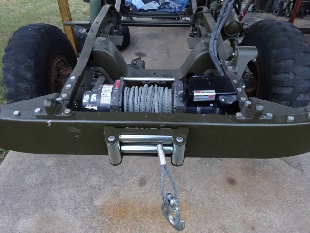

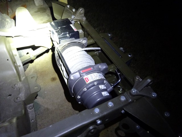

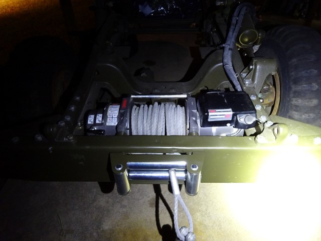

Got it in! Better pics tomorrow.
DSC00972 (Small).JPG (92.42 KiB) Viewed 31637 times
DSC00973 (Small).JPG (102.08 KiB) Viewed 31637 times

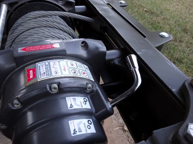

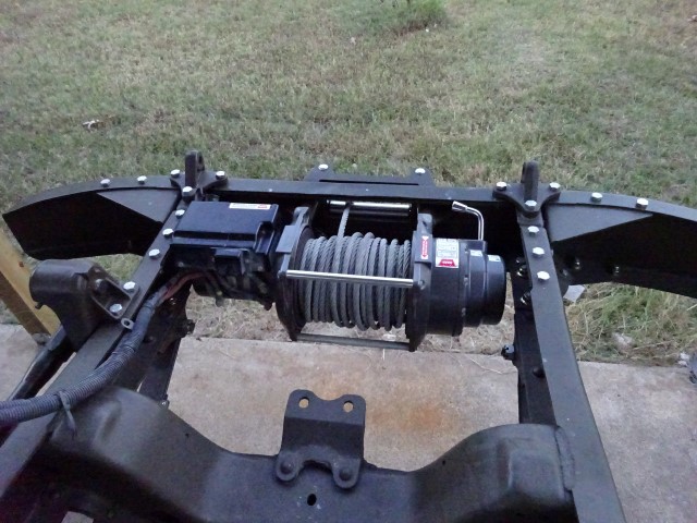

A couple of daytime pics.
DSC00979 (Small).JPG (122.87 KiB) Viewed 31628 times
DSC00980 (Small).JPG (117.14 KiB) Viewed 31628 times
DSC00978 (Small).JPG (132.86 KiB) Viewed 31628 times
