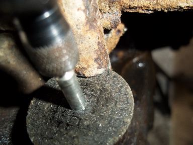

Hi Rick,
For what it's worth, my Dremel tool has been invaluable over the years, cutting a relief slice into frozen nuts in order to remove them (in the absence of a torch). The cutoff wheel is about 1 inch in diameter and works well in those tight spots. I even cut off a frozen leaf spring U-Bolt with mine several years ago with no problem at all (picture added).

- spring_3.jpg (50.1 KiB) Viewed 10022 times
