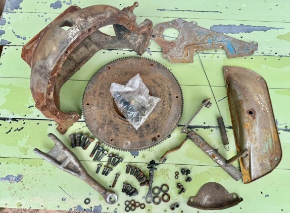

Google tells me that a 1962 slant six manual bellhousing off a 1962 crew cab W200 will NOT fit a 318 of similar vintage, so either my memory of using one has failed me, or I lucked out. Wish I had taken a photograph.
Edit- My manual shift donor bellhousing was off my 1962 Air Force Slant Six W200 Crew Cab.
Very rare and low starter location similar or identical to the one in this photo.
I converted the clutch linkage to hydraulic.
It and the 318 went back into the W200 Crew Cab when I converted the 37 to the Chevy engine.
