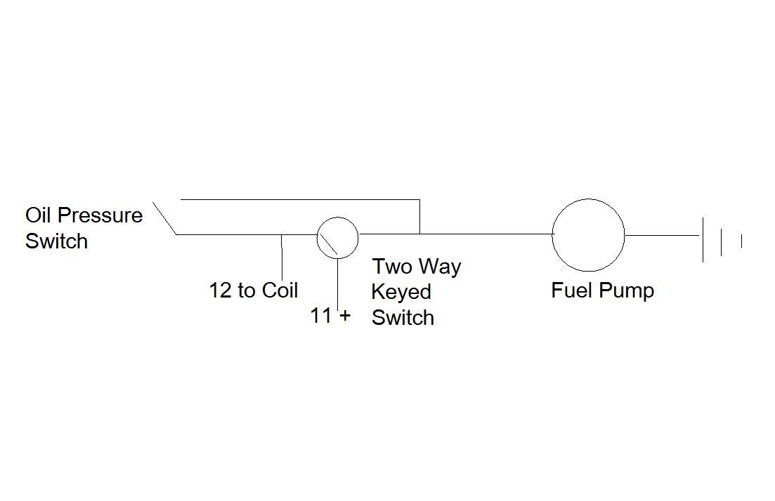

When wiring that oil pressure relay, how do you wire it so the fuel pump runs when starting, or if you want to prime the fuel lines? Do you just have a bypass switch to force the pump on?

John Mc wrote: Sat Nov 25, 2023 5:36 am When wiring that oil pressure relay, how do you wire it so the fuel pump runs when starting, or if you want to prime the fuel lines? Do you just have a bypass switch to force the pump on?
Since the carb has a float bowl I'm going to have a momentary switch just for priming. I was going to run a wire from the switched side of the starter relay but the way they're designed it's an almost impossible task as there's no relay.

Here is what I did. Need a 3-way key switch.
M37

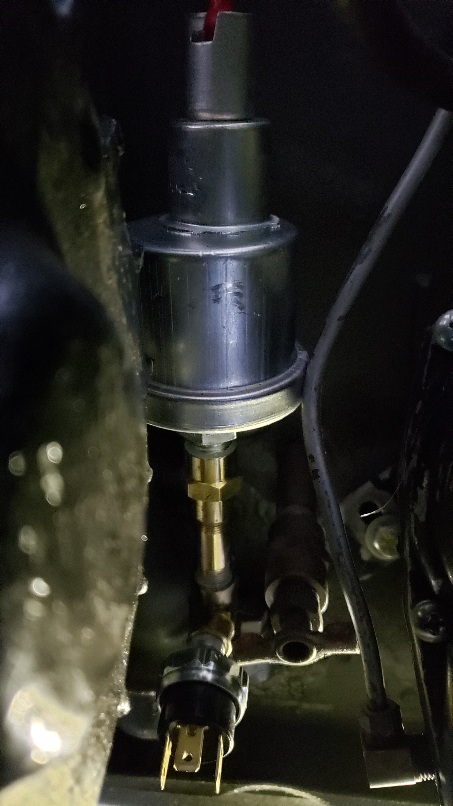

The correct pressure sender and safety switch is installed..
- Utilized the T that was already there.
- Removed the mechanical gauge and 4" nipple.
- Removed the OEM tubing to the (incorrect) sender.
- Put the switch in place of the flared tube
- Used a 1" long 1/8" MIP nipple to lower the sender due to the new PS hoses at the OEM height of the sender.
- Need to fab a custom clamp/bracket as it wasn't there.
Wiring now...
You would think for a big truck there would be more room. Surprisingly it's so tightly packed in there.

Fuel pump complete, need to dress the wires.
Had the chance to pick up a set of 315/85r16 MT tires. Need to mount 2 at a time cause I only have 2 jack stands. :oops:
New flaps and radial tubes with the new tires. Not quite the order in which I wanted to do things but when the deals show up one has to go with it.
No pictures till the wires are dressed and all tires are on.

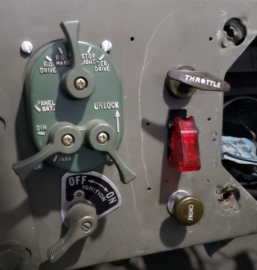

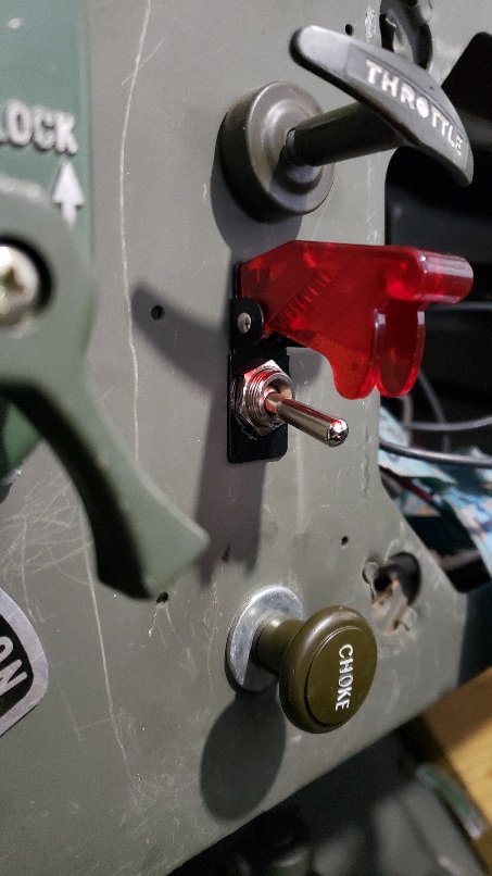

Mounted the fuel priming switch.
Found that the spider harness that supplies 24v to the gauges was on it's last leg (pun intended). Easy enough to fab a new one. Also found an intermittent connection in the oil pressure wire. Now all the gauges are working! Still need to replace the temp gauge so all are new.

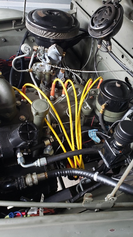

Rdinatal
Posts: 179
Re: New to me '52 M37
Post by Rdinatal »

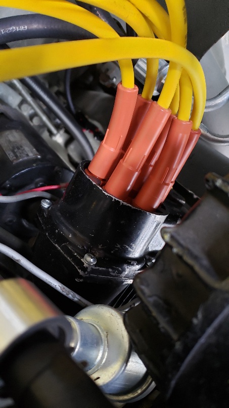

Changed the plugs and tossed the resistance wires for solid core.
The .mil distributor had the waterproof cap removed to expose the inner cap and had regular wires. Now I know why. The waterproof wires are expensive!
Ended up making a custom length set. 8mm wires fit perfectly into the inner cap towers. A little soapy water to overcome the interference fit of the wires with plug boots to give a good snug fit over everything.
Yes, another tool to crimp the ends (but this one will be used over).
Soon: Wipers

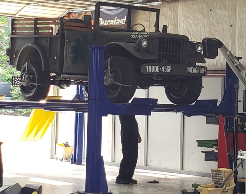

Drivability has greatly increased.
Getting aligned is a bigger task than I thought. It was way toe out! Other than that the back/front tracks spot on.
