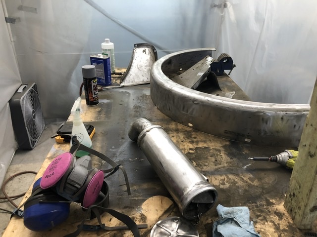

Strippin’ paint, coating with Ospho. Now I have a sanding booth and coating booth. Jealous of you guys painting outside in the winter, the garage is a mess!

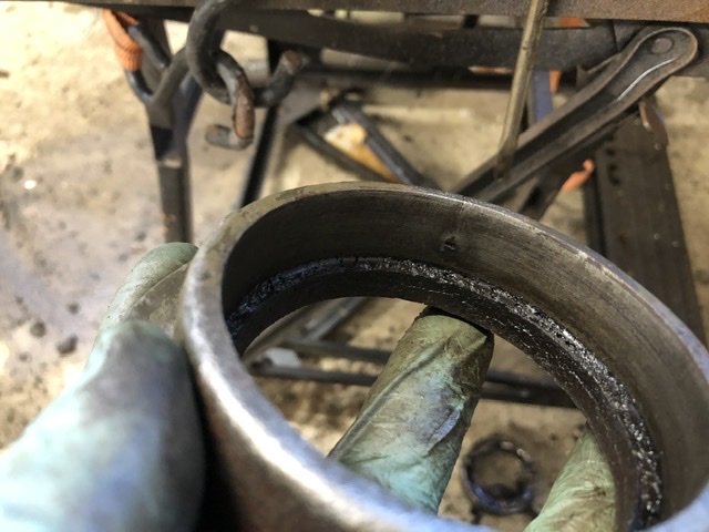

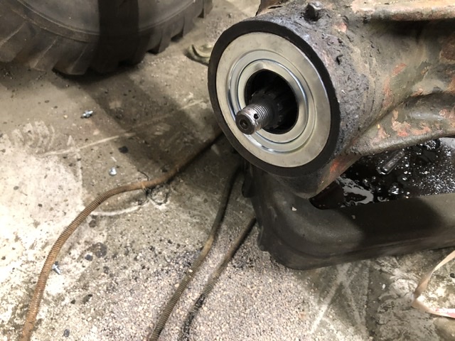

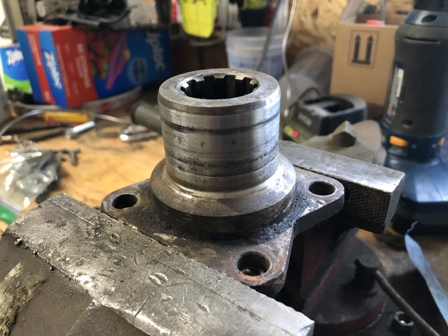

Taking a break from sanding, so replaced the rear pinion seal. Had to break down and buy a oxy/MAPP torch. A tank of O2 later and the seal fell out. Run a shrinker bead all the way round. Could have skipped all the pounding.
Used some anaerobic sealer around the OD of the new lip seal housing from MWM. Waiting on a Speedi sleeve. I don’t want to do this job again!

Man that yoke looks all too familiar-speedy sleeve is right!

I just went through this job as well, but luckily my seal came out without too much effort. I opted to replace the old leather seal with a new SKF seal, reusing the old seal housing. I also replaced the nut on the pinion gear as it was all cracked up too.
My flange has a large dust shield on it too, unlike yours.
Your finished product looks great. Was the shrinking bead just to reduce the interference for a little?

When I have to get that seal out it's a pain in the butt. Now I just drill a hole for a bolt that fits in my slide hammer in the face of the seal. Tap threads in it. Thread the bolt in and bang away with the slide hammer. Most of the time it will pound on out. Sometimes I have to drill another hole, thread and pound again as the first one pulled out of the threaded hole.

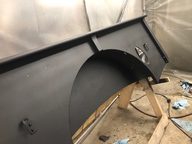

Just putting my process out there in case I'm missing something, or someone wants to tackle painting.
Shave beard
Prep part (get to bare steel, treat with Ospho)
Put on Tyvek suit
Put on respirator (before opening any chemical!) Make sure its an OV (organic vapor) respirator.
Put on nitrile gloves
Turn on exhaust fan in booth, spray floor with water to keep the dust down
open windows (until it gets to 60, I'll have to leave the garage door closed)
Clean part with Eastwood Pre Paint (It's a mix of naptha, xelene, and toluene) until rag wipes clean. Wipe in one direction so you're pulling the dirt not swirling it around.
Tack rag parts
Put on goggles
Mix primer (I'm using low-voc 2-part from Eastwood. no Iso. again, not 'safe' but no iso)
Apply primer (as you can see, still trying to figure this out. I guess the place to make mistakes is in the primer not the topcoat)
Clean gun using lacquer thinner
dump spent solution into waste can and seal.
Remove googles, gloves and suit.
Shut windows and lock garage (do not enter for 12 hours)
Remove respirator and store in ziplock. (I change cartridges once a month or 8 shots, whichever is first)
Leave shoes outside until tomorrow.
You can top coat or recoat epoxy within 5 days of spraying, after that you have to scuff it prior. I use a green scrubbie.
