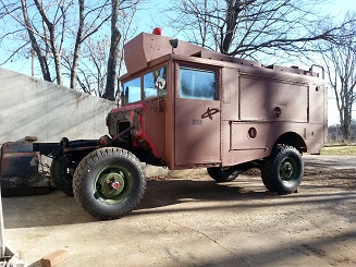

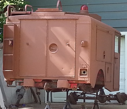

Truck is closer to transplant. Only a couple of more things to remove for reconditioning. Then put it all back in.

Looks like this now. Soon... Soon

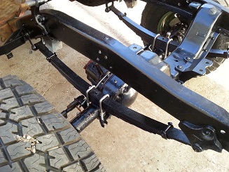

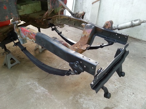

More pics on slow progress.
Re: R2 crash truck
Hey, good work-keep after it!
Re: R2 crash truck
I have enjoyed following your work progress and am curious as to what you are using to coat the front end of the frame?

Wire wheeled the loose rust off the used Rustoleum rust converter on it. then semi gloss black. Getting front ready to hang motor. Get paint on it to make stuff later easier to do. Hope to have 3rd members back in axles next weekend as well as redone xfer case. Then back on frame.

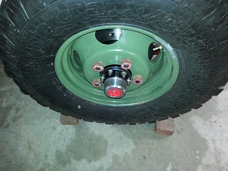

More updates and a suprise.
New front hubs.
New front hubs.
rebuilt front axle. Rear as well.
Back on wheels
Back on wheels

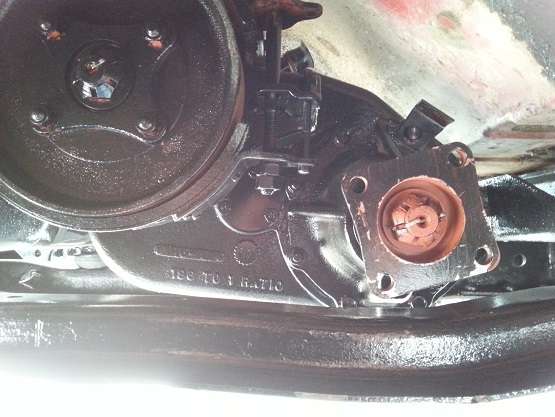

Now for a surprise.
Can you guess whats wrong. Done by VINTAGE POWERWAGONS

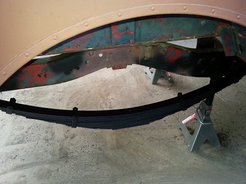

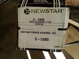

New shocks. Don't fit either front or rear. Fully extended don't reach shock post. Suppose to be replacements.
Direct replacements my butt.

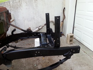

One more whats wrong. This and diffs were done at vintage power wagons.
Aaahhhhhrrgggg.
Aaahhhhhrrgggg.

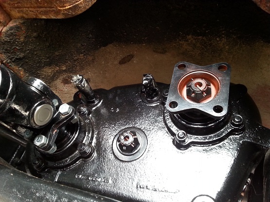

Today was going to put in rebuilt drive shafts. Only got the front one on. And you can see why. Probably the last nice day till spring that I'll get outside to work on her. And it was wasted.
isaac_alaska
Posts: 557
Re: R2 crash truck
Post by isaac_alaska »
Haven't seen enough transfer cases to spot the oops on this one
