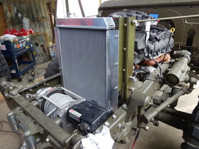

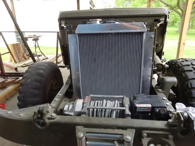

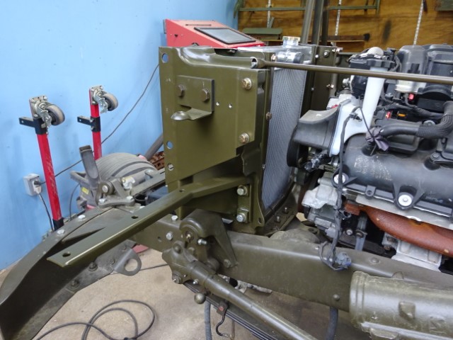

Radiator in.
Can't upload pics, says "check your PHP installation. What the heck is that??

Re: 1954 M37 rebuild thread
Post by RCrombie »
Looks good! What radiator is that?

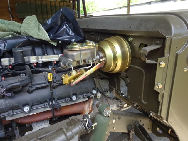

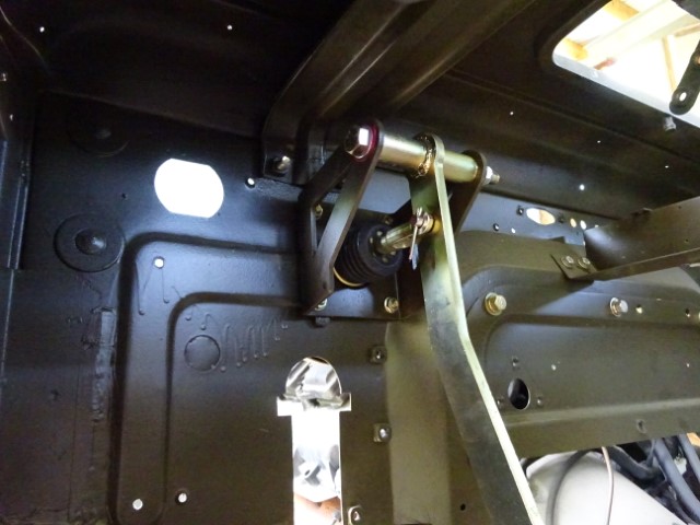

Booster installed.
Posts: 1822
Nice job on the brake booster install. Please share the part numbers and who sells the items for this.

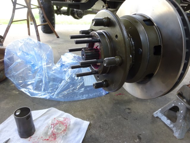

DSC01280 (Small).JPG (120.35 KiB) Viewed 4351 times

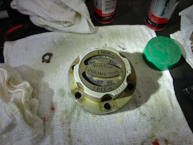

Wondering what I'm doing?
DSC01282 (Small).JPG (122.52 KiB) Viewed 4351 times

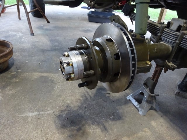

This! Found some real Warn hubs (M13)
now to clean them up.
DSC01288 (Small).JPG (118.32 KiB) Viewed 4318 times
DSC01287 (Small).JPG (111.69 KiB) Viewed 4318 times
one side done.

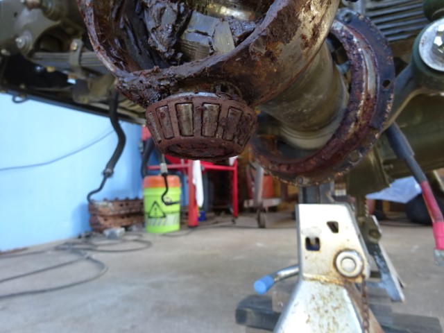

DSC01299 (Small).JPG (108.35 KiB) Viewed 4186 times
This is why you do the bottom grease fitting mod!

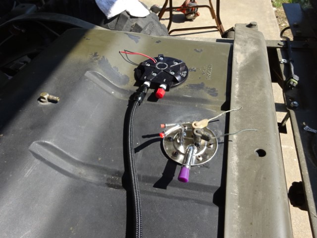

DSC01303 (Small).JPG (109.62 KiB) Viewed 4159 times
Installed in tank fuel injection pump. I used teflon fuel line with SS braid & black nylon outer braid.
