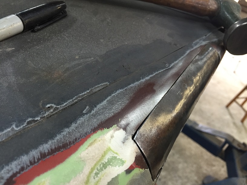

Couple more pics
Actually started filling some of the repairs to the rocker panels I made last year. And started some on top of cowl that I replaced. Hope to maybe paint cab this weekend if weather is nice. I don't care for painting in the shop as it gets on welders, tool boxes etc, So outside in the sun for me. :D

That turned out nice.

Thanks, Sometimes might have to make a couple before get it right but that one worked out first time. Lucky!

Great job with the hammer and dolly. Making great progress now.

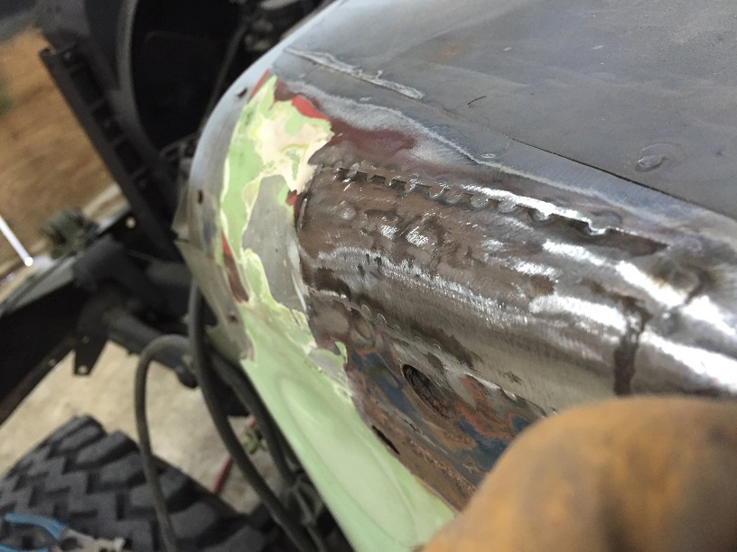

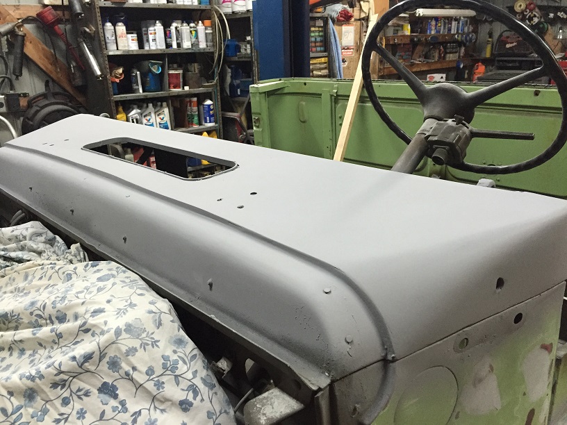

Finally got the cowl about done, all primed, but then found one low spot along edge so had to touch up a little after this pic, then prime again. these cowls are anything but straight across. they tend to slope in a couple different directions. :shock:

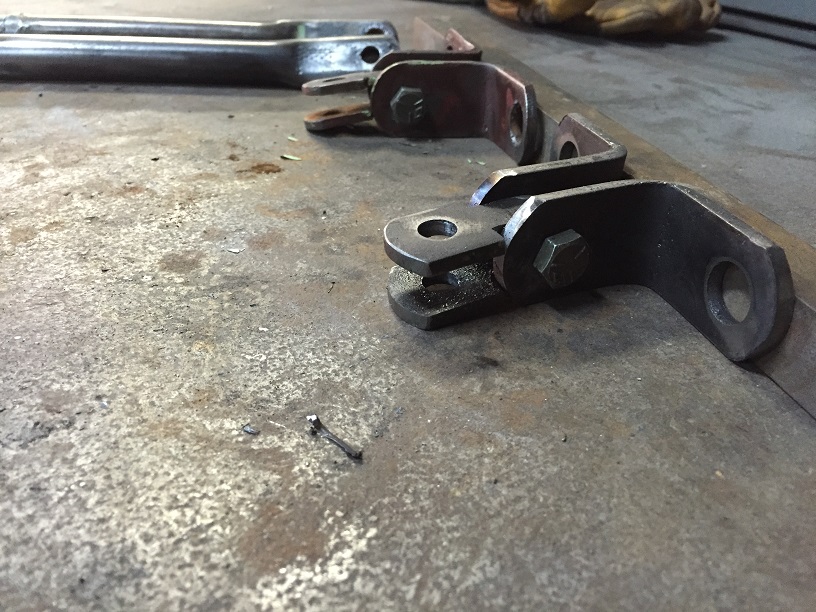

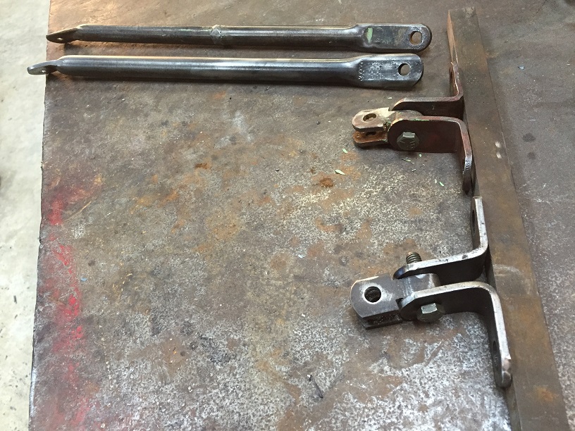

This truck had one driver side mirror, not sure if original or not. Either way my wife wants a passenger side mirror as well, She is only 5'3" so looking over tailgate is about impossible. So I decided to make brackets for the passenger side same as driver side. Of course had to straighten driver side as they were all bent up. I made a new arm for mirror as well. Similar to driver side. The arm at top has been welded in the middle so I'm thinking someone made that one. Made out good with mirror brackets, actually better as mine are straight :P the mirror brackets seemed to be angled forward slightly so I made mine that way as well.

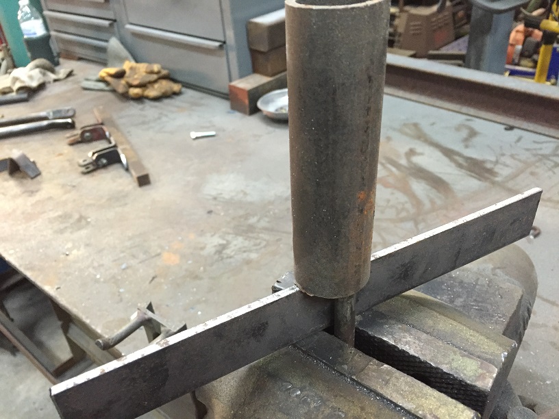

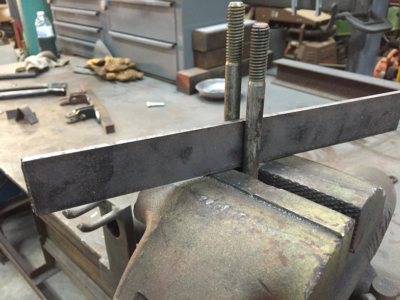

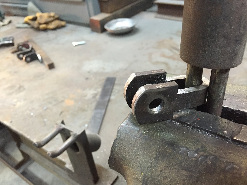

Neat trick for bending flat bar tight. I have a bender for flat bar/solid rod etc, but it wont bend it tight like say 3/8". So I use {2} 4" x 3/8 bolts, or whatever size loop you need. Like could use 1/2" bolts for 1/2" loop. Clamp them in the vise with stock material between them, to give you the space. If you tried to bend the flat bar now, it would force the tops of the bolts outwards. So... slip a piece of pipe that fits close to the distance the bolts are apart. This piece of stock was 1-1/4" x 3/16" and I bent it a tight 3/8" cold. Just hammer and hold one end against bolt. Stupid trick but easy to do.

I am ready for some crab, I also did my mirrors several years ago. Are you using the fording/snorkel mounting screws holes for the passenger side?

The mirror that was on the driver side used the windshield pivot point. That cast piece that mounts on side of cowl. Not sure where it was originally. But didn't look bad. So I made one for other side just like it. If wrong at lest the same. :D

Where on the Eastern shore are you, St. Mike's/ Easton? Hour plus drive is great. I used one of the fording bolt holes, I try and post a pic, I never thought about doing the opposite of the drivers side? :oops:
