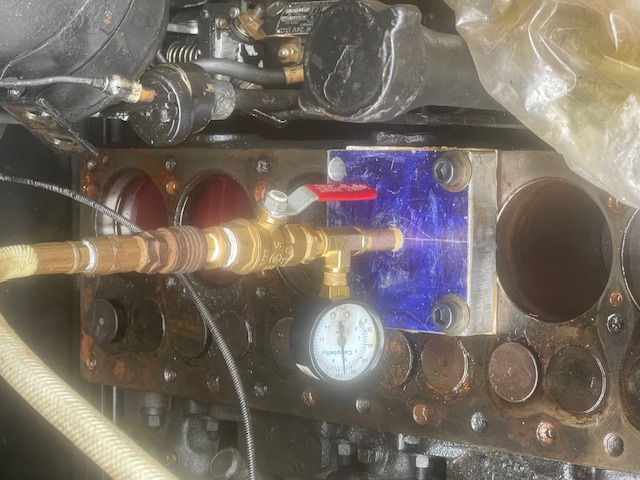

It has been in the 90s. It is too hot to do anything too strenuous. I have been keeping the cylinders soaking. I am still a little concerned with the cylinders that are staying full of the ATF and PB Blaster. I came up with one of my crazy ideas today. I made an individual temporary head that I can bolt down and pressurize the cylinder, hoping to aid in the capillary action of the penetrating oil. Wish me luck. Let me know if you think it is silly. It has been soaking for weeks now.

Re: My 1962 Project 😵💫
That's an interesting option-pressurizing the cylinder to force the piston. However, you're trying to move all of the rotating mass using a single pressure point. Perhaps you'd have more luck if you could somehow pressurize all 6.
Just my 2 cents,
If it were me, I'd use your close-off plate and connect a small hydraulic hand pump & oil.
The Porta-Power pump comes to mind, and it will develop enough pressure to turn the crank without a doubt.
Compressed air can give quite a explosion if something goes loose, whereas using a liquid doesn't have that inherent danger.
The same thing is done, more or less, with water to hydro test high-pressure welding tanks.
Well, I guess i didn’t explain what I wanted to do. The air pressure isn’t for actually breaking it free. it was to help the JB Blaster help penetrate the rings. Unfortunately it has been holding pressure for a week now. You would have thought it would have leaked down by now.

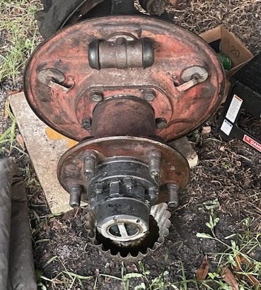

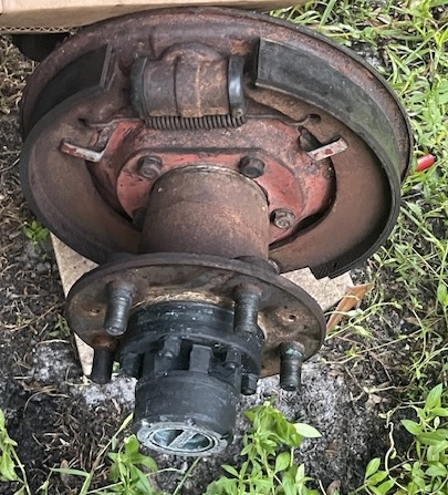

I learned something this week.
#1 Use the manuals!
#2 Don’t take for granted that the previous owner did things correctly.
I replaced the front wheel cylinders the same way they came off. They are backwards, so now I have some rework to do. I found this out when I removed the rear wheel cylinders and only one was marked with an “R” for right side. It was correct, left side was not marked or correct.
#1 Use the manuals!
