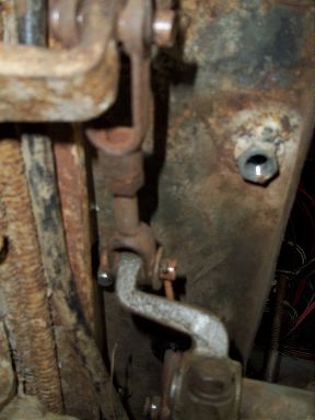

There is one other option: order a Powerwagon Clutch rod from Vintage Power Wagons. It has an adjustable clevis on one end. I use one on my M37-similar issues to yours, Cliff before I installed the PW rod.
Power Wagon clutch rod.JPG (18.1 KiB) Viewed 2268 times

Thanks for the suggestion about the power wagon clutch rod. I will order one before I take my truck in to the shop for repair. Hopefully that will fix it like it did yours. Cliff
