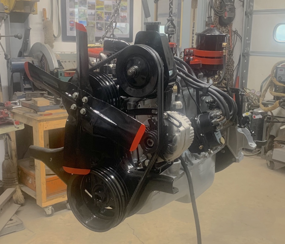

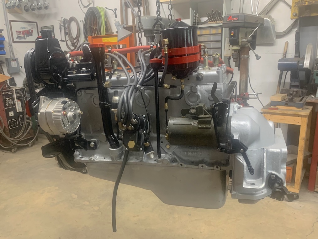

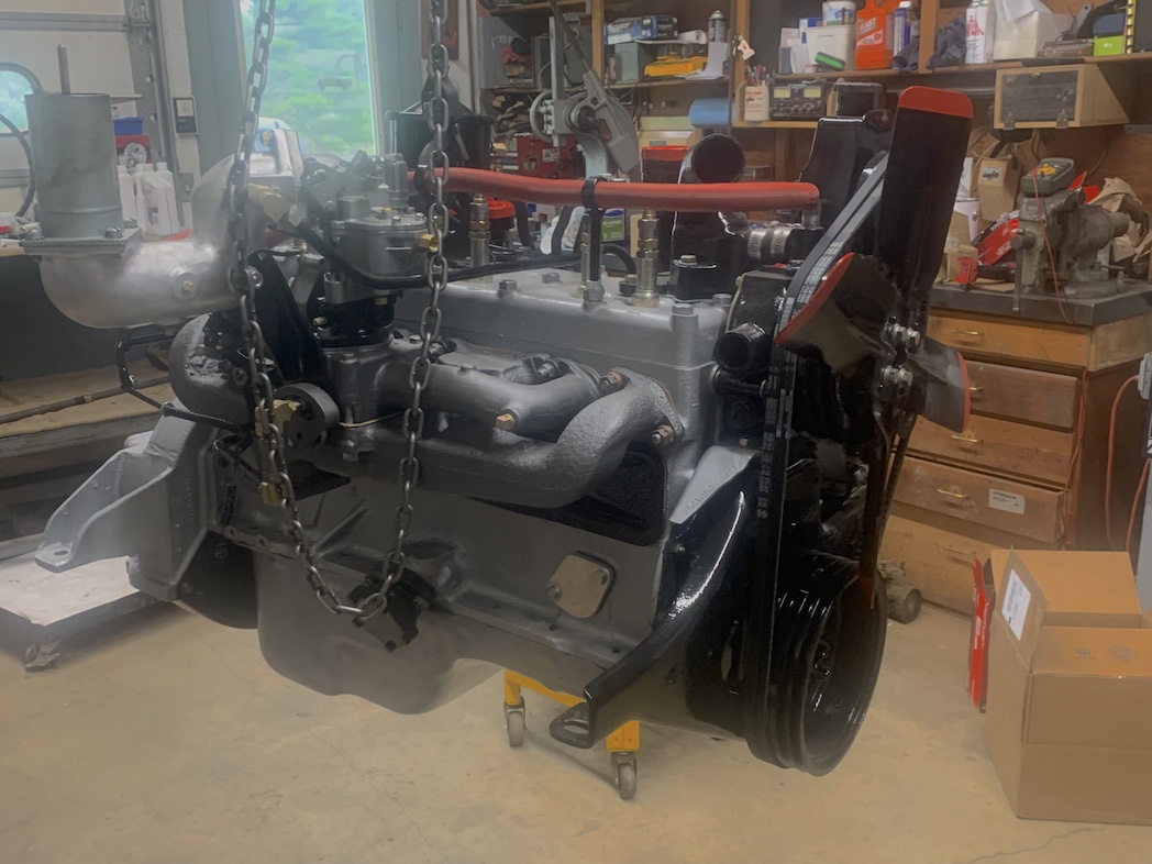

I picked up the radiator today from where it was being repaired/repainted. It gave me a good excuse to swing by Distinctive Restoration and see how Tim was doing. He had the engine all together with accessories mounted. It's looking really good. The power steering set up is much nicer than what was in my truck before (a cobbed together bracket that left the pump pully slightly mis-aligned with the engine). We got the mounting bracket from Greg Coffin. Since this was for mounting on a 251, and his design was for a 230, the bracket came in a couple of pieces, to allow Tim to adjust as necessary to get the alignment. The bracket is much more solid, and alignment is spot on.
Engine L.jpg (239.62 KiB) Viewed 8001 times
Engine F.jpg (239.37 KiB) Viewed 8001 times
Engine R.jpg (231.62 KiB) Viewed 8001 times

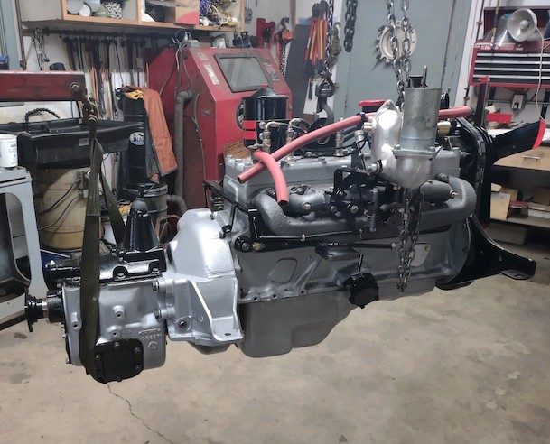

Re: M37 "Brutus"

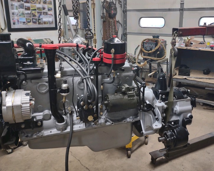

Tim just sent me some pics of the transmission mounted up on the engine:
Trans mounted 2.jpg (126.42 KiB) Viewed 8000 times
Trans mounted 1.jpg (92.02 KiB) Viewed 8000 times
Re: M37 "Brutus"
Wow does that all look NICE!
Well Done!

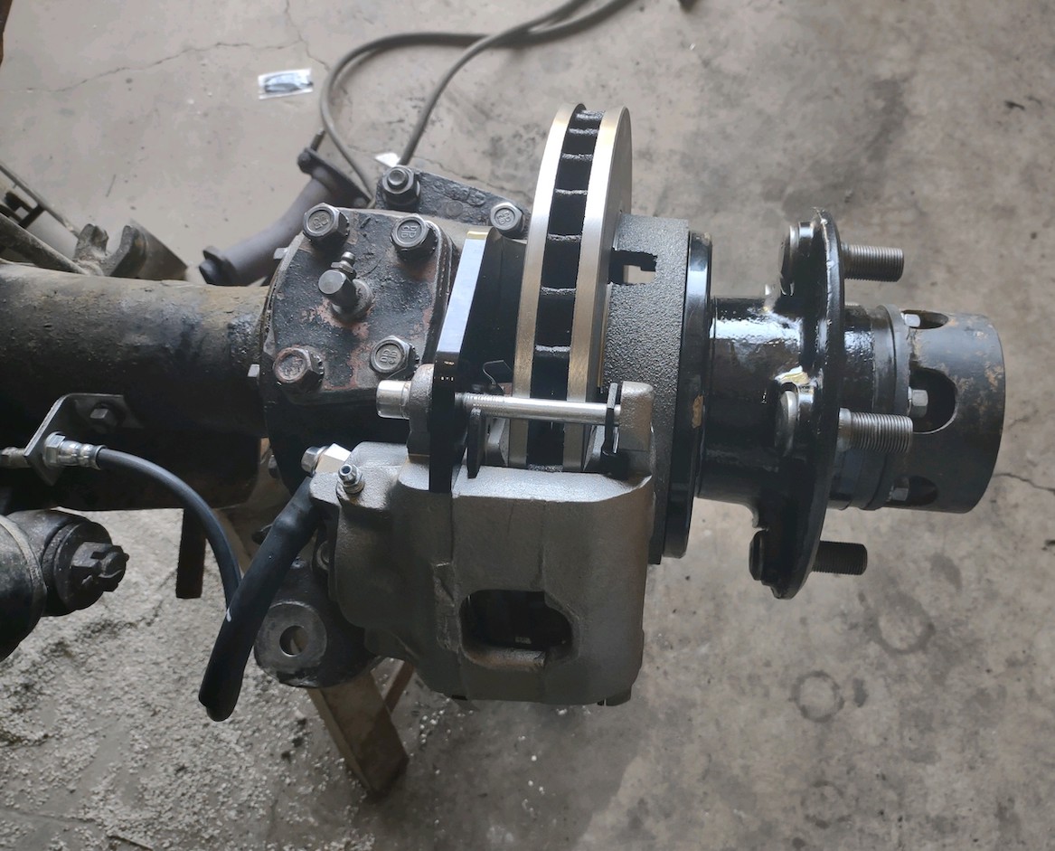

Tim has been hard at work: disassembled, cleaned up, and reassembled the front axles and hubs prior and installed the front disk break conversion kit:
Disk brake conversion sm.jpg (221.4 KiB) Viewed 7954 times

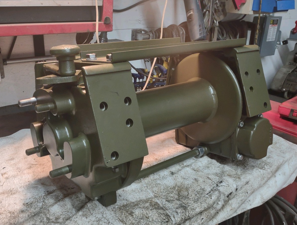

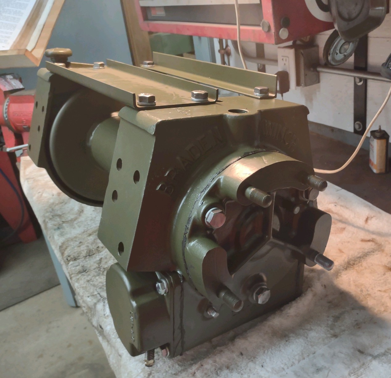

And rebuilding the winch:
Winch rebuilt 2 sm.jpg (242.14 KiB) Viewed 7954 times
Winch rebuilt 1 sm.jpg (232.83 KiB) Viewed 7954 times
Re: M37 "Brutus"
Nice! I hadn't seen Bryan Sage's lockout guards in quite a while-lookin' good!
Posts: 435
Re: M37 "Brutus"
Cal_Gary wrote:Nice! I hadn't seen Bryan Sage's lockout guards in quite a while-lookin' good!
They were on it when I bought the truck. A necessary precaution for how I use the truck in the woods. clearance is a little tight to get my fingers in there, but it works. Tim says he's seen folks make some sort of removable adapter handle to make locking and unlocking them easier. I have not found that necessary, but I suppose the day is coming where I might need a little help with that.
Re: M37 "Brutus"
Or you can go with shorter (and more expensive) lock-outs. I run the SuperWinches/AVNs-they stick out farther than Selectros or Warns.
