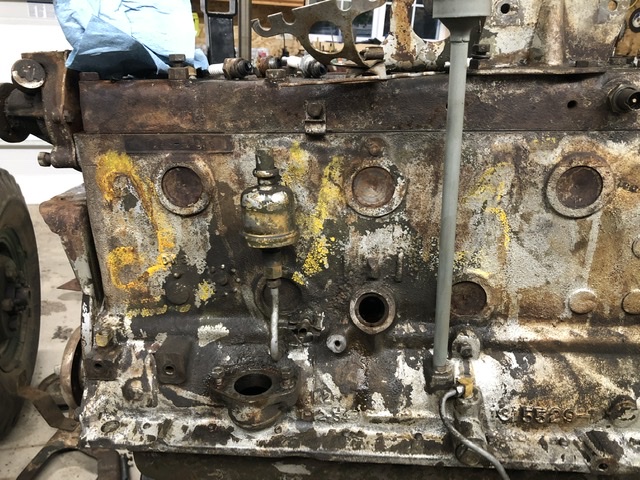

I wonder what these numbers were for? Cool to see the silver paint.

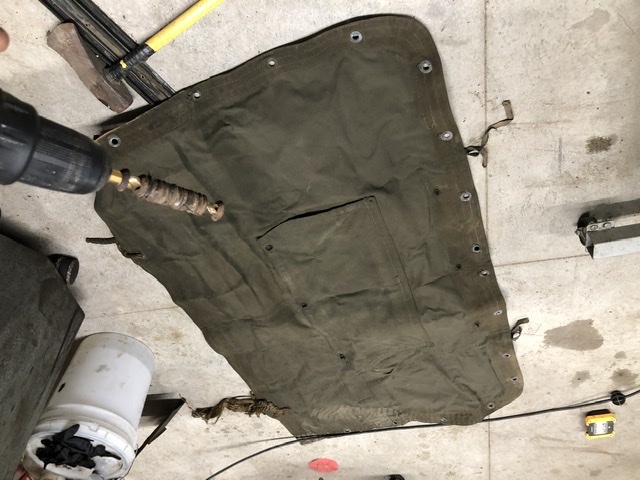

Found the back of the troop cover canvas in one of the bed storage cubbies. Score!

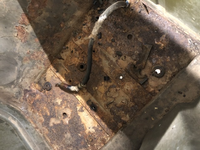

More rust. Not surprised, I doubt there are any panels out there?

Re: Grandpa’s M37
Youch!
No patch panels for the battery box floor that I'm aware of. You may need to fab one up, or find a scrap cab with a decent floor where you can cut out what you need then replace the rotted floor in yours.

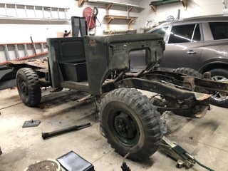

It feels like I’m close to done with the tear down, but since this is my first rodeo I have no idea.

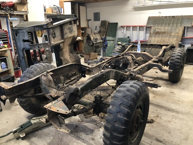

Back to the fun.
Touchdown!

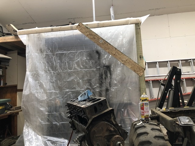

Took a break for hunting. Frame is ready for blasting but the war department has other ideas for liquid assets. Was able to set up a booth for sanding/spraying.

Re: Grandpa’s M37
Looking good Greeno! With Winter on our door step things will be slowed to focus on snow removal and other distractions.

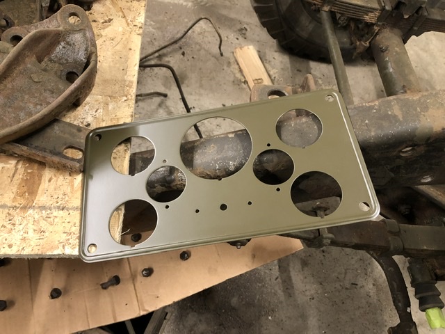

“Just do one little thing”. So I painted my instrument insert.

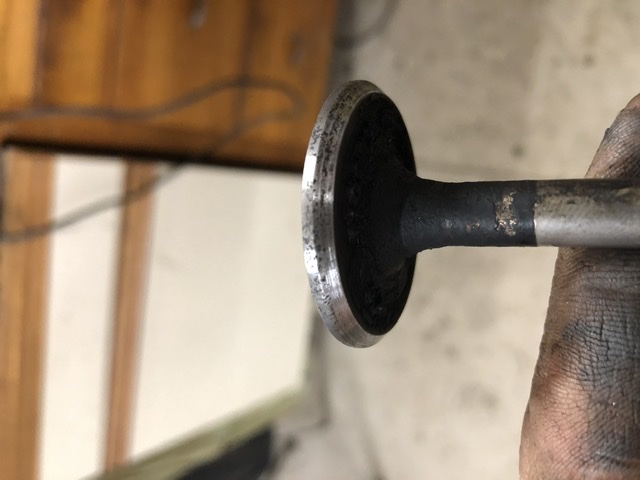

Too much pitting on the exhaust valves. Add em to the list.
