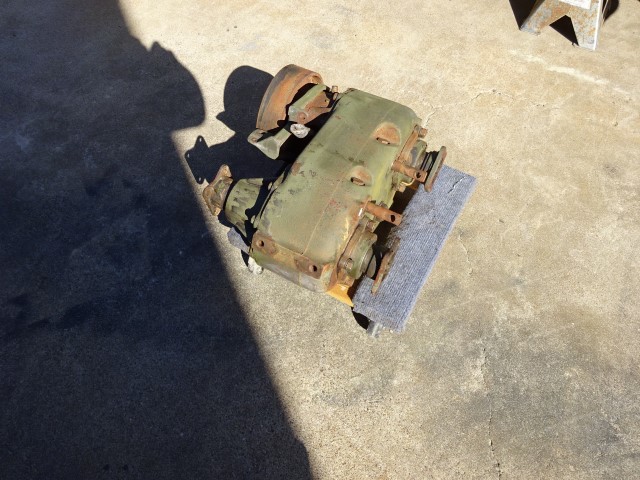

Well, I'm ready to get into it. The tag on the bottom says it was rebuilt in '75. Almost no play at any of the yokes- all turns smoothly, so I hope to get it done with new seals and shift rods. Got my fingers crossed!

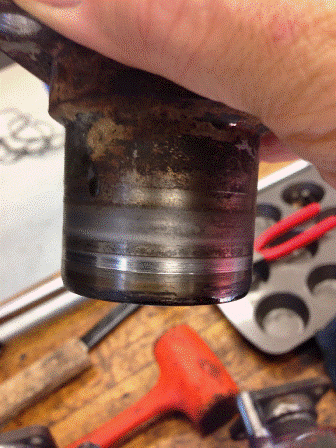

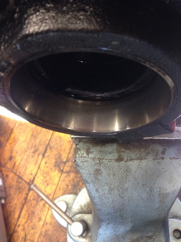

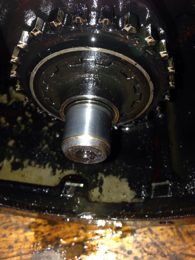

Here's the flange for the rear driveshaft. The area where the seal's lip made contact is well worn. The area where the felt ran is not too bad. I guess it stayed oil saturated over the years!
Worn but OK...
Worn but OK...
Not good... (edit: mating outupt gear killed too)

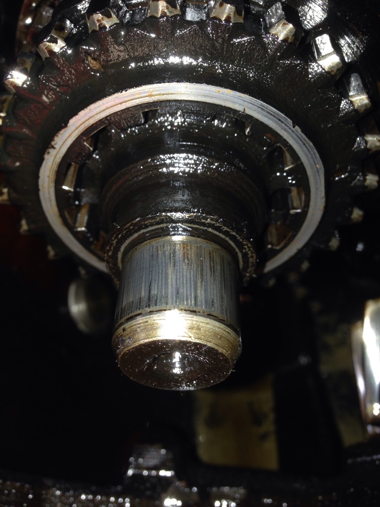

Tired! Looks like 1954 may be the last time this thing saw any TLC.

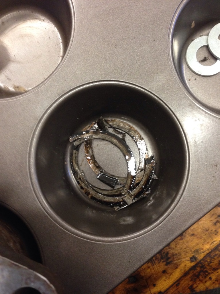

Now this is a weird one. The shims were destroyed! The preload on the bearing was OK, but when we pulled the flange the shims just fell apart. Guess we are not doing this too soon.

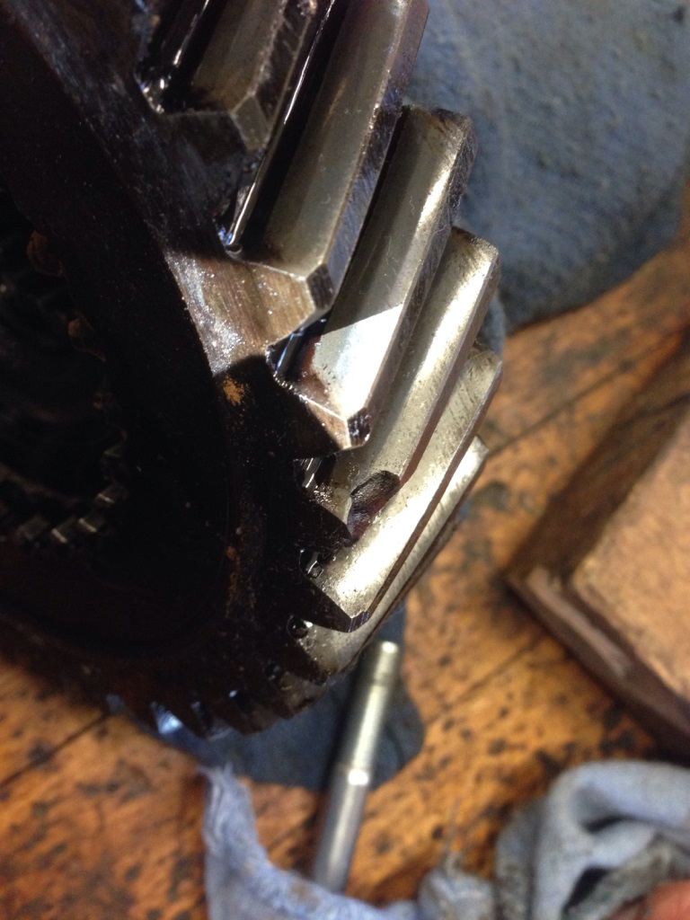

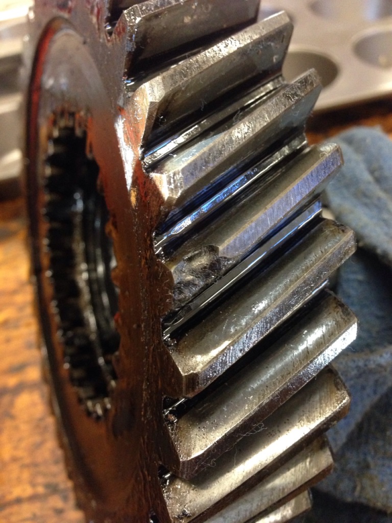

Ouch! I think I can run this with a bit of dress up. It's probably been like this for many decades, possibly since new. (edit: It ate something, the mating gear has some damage too. Hope to find a better one.)
Another shot of the missing chunk.

Andy, I'd guess that there's a small piece of shim unaccounted for, and it went through those gears, breaking out a chunk of that one tooth?
One of the NP420 transmissions that I disassembled had the same failures of the shims, and the PTO was missing an entire tooth on one of the gears. The broken tooth and the remains of the shims were in the bottom of the case. Oddly enough, until I tore it apart, there was no indication of anything wrong internally, other than the usual sloppy shifting.

I have some random NOS gears in my pile from buying grab bags from ABLinn. Shoot me some good pics and some dimensions of that gear and I'll see if I have a match.
