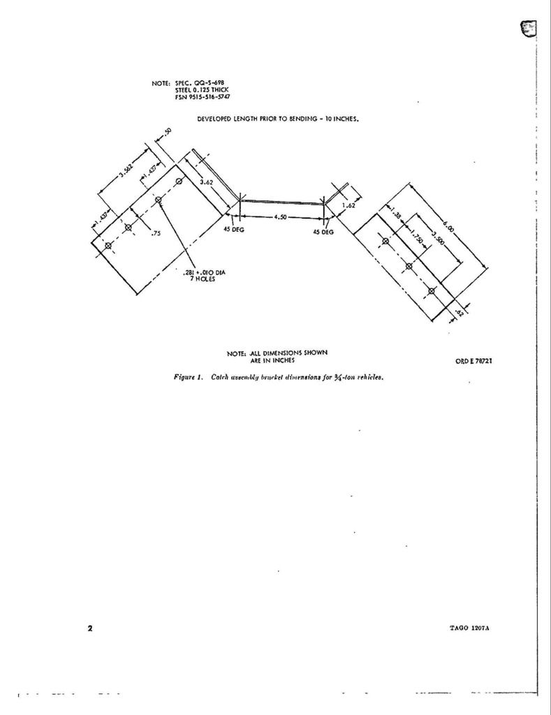

Glad I made it home to receive all this intel! Looks like I can build the upper bracket easy enough. I've got the spring loaded upper rifle retainer thingy. Anyone have an extra butt holder for sale?
