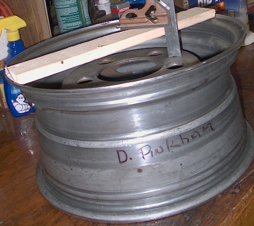

Let me try to attach a picture of my first Stockton built rim so you can see the rim.
- Initial tack up of rim built by Stockton
- M37 wheel test fit 1 50percent.jpg (158.79 KiB) Viewed 1100 times

Re: M37 radials - Charles what did you use?

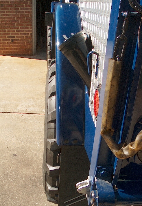

Does my picture show what you consider a shortened height bead seat? Harley at Stockton told me this rim is considered a shallow drop rim which allows the backspacing to be really close to original since he can shift the location of the milled Budd Center to get the back space to just barely clear the drum or modified disk brake set up. Staying close to the original back space avoids adding side loads to the wheel bearing the original was not designed for. It also keeps the wheels from sticking to far out past the fenders. see next picture
- Michelins XL installed on rim with amount potruding past fender
- M37 all Michelin XL profile 1 50 percent.jpg (247.33 KiB) Viewed 1100 times
Hey DAP:
What I'm referring to can best be explained here: http://eastsidecustomtruck.com/files/wheel-diagram.gif
The Inboard & Outboard rim bead seat are the areas of concern... the height of the bead seat is where you may have issues if trying to mount
the Michelin XML 325/85R16 tire - the Michelins have a taller bead in profile & MAY not seat properly on Stockton rims. You'll need to look at the Stockton rim you have
and compare the bead seat lip height to the taller lip height of bead seat on the stock M37 rim - see the difference in height?
Tanner
