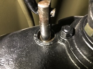

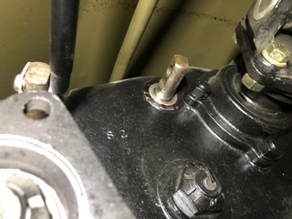

Changed the selector shaft seal this am. Thanks PoW that worked great. I don’t think this is a permanent fix, as there is a small pit in the shaft. Hope this will get me to winter.

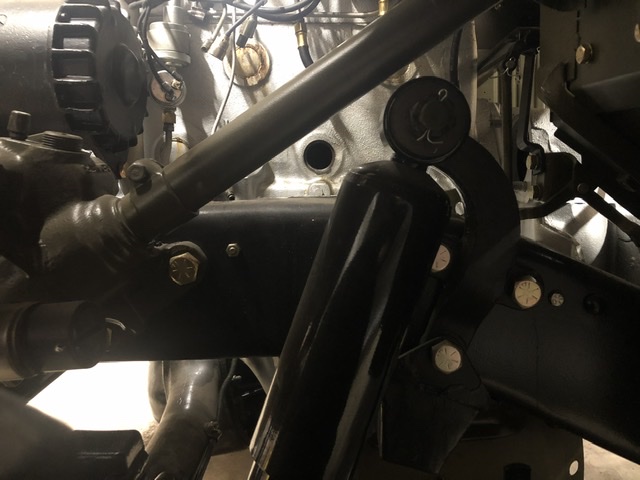

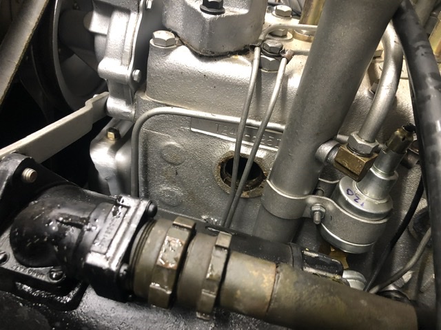

Well, so much for the parade Sunday. Blew the frost plug behind the starter. Grrrr. Hope I didn’t wreck it.

after another frost plug popped out last night I’m in quite a state. I paid good money for a supposedly professional rebuild by a shop with 230 experience.

What a pain. I don't know if taking the truck to the shop to claim will be a burden for you.
One thing you can do, before tapping them back, is to apply Indian Head compound. That will help on the sealing. It's widely used here at the marina where I live.
Sebastian
Sebastian
Re: Grandpa’s M37
They didn't do a good job with those. The worst one is in the rear of the block, inside the bell housing.
Hope it never leaks... :shock:
BTW, they are called core plugs, nothing to do with freezing engines. The factory places them to ease the removal of the sand fill after casting the iron. The steel wire you occasionally find in an engine block is from the armature used to hold the damp sand together and in place before filling the mold with molten iron.
I've seen many engines ruined by freezing, with every plug in place just fine.
Re: Grandpa’s M37
Tough situation and I would hold the shop accountable for the repairs.
I learned about those plugs myself a couple of years ago, not properly staking them then lost one with 2 brand new gallons of coolant all over the street.
Lesson learned.

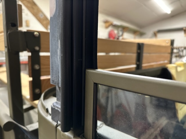

Test fitting window seals before I paint the uprights.
