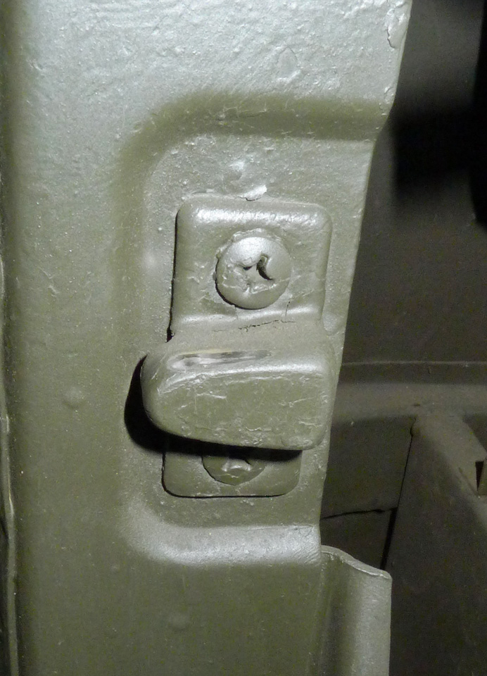

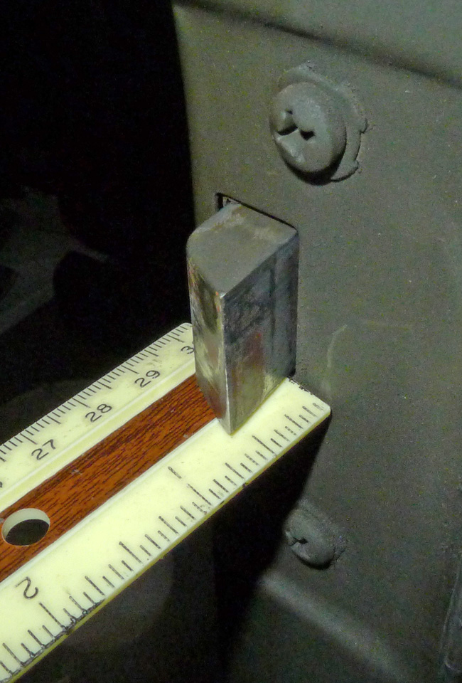

Here are a couple of pics of my passenger side door latch for reference.
