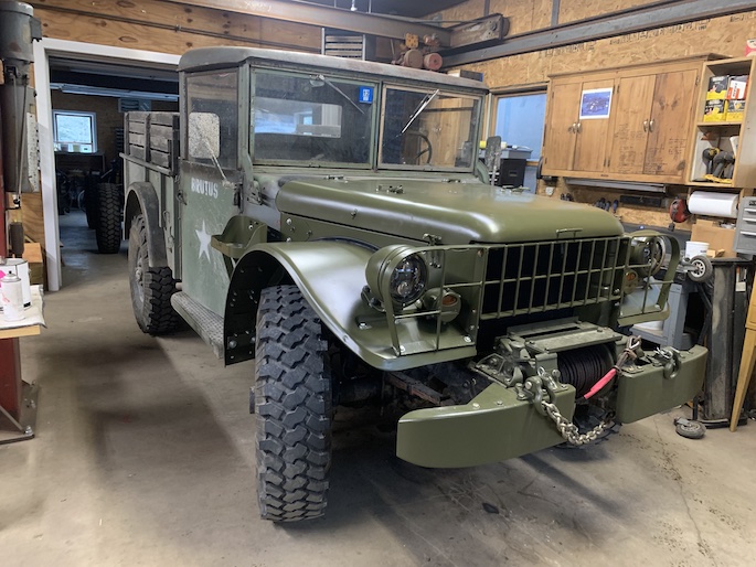

The center band of tread blocks running around he circumference of the tire is wearing unevenly. Some blocks are high - up about where I'd expect tot see them (I've got about 10,000 miles on the tires). Others are worn low. IT seems to alternate high and low. It's not exactly every other block, but it's close to that. There is enough difference that it can easily be seen by eye. I doubt a photo would show it. The picture below is an old one, before the wear was apparent. I'm including it just to show what the tread pattern is. There are 3 bands of tread running around the circumference of the tire. Only the middle band shows the wear at this point. (I suspect the tires are running mostly on the middle band of tread at the moment. I'm running 40 PSI. I probably could be running a good bit lower than that: the tires are designed for much heavier loads than an M37. From the specs for these tires I found online, at 40 PSI they are rated high enough to carry the full weight of the truck on just one axle.) The rear wheels are wearing normally.

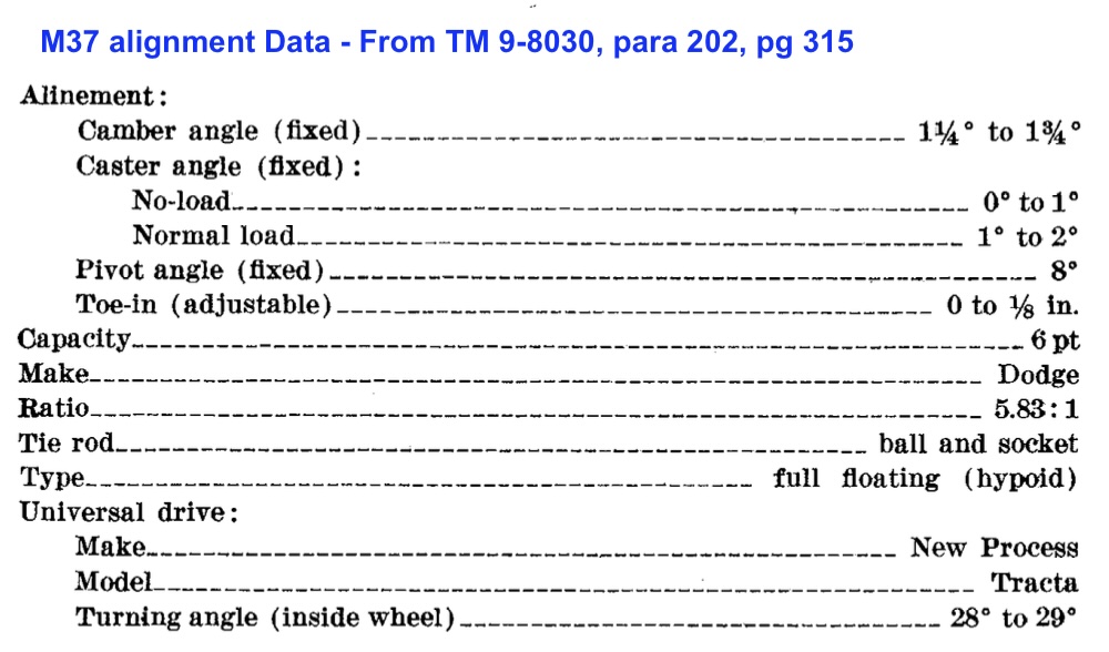

While searching the manuals, I did find the specs for caster and camber in TM 9-8030 (on page 315 at the top of the "Front Axle" section) I could not find that info in the newer TM 9-2320-212-20. As already noted, those are fixed settings, but at least I'll have that information to check whether the accident I had several years ago messed up the frame or something.
In case anyone else needs the alignment data:
- M37 alignment data.jpg (157.95 KiB) Viewed 15170 times
