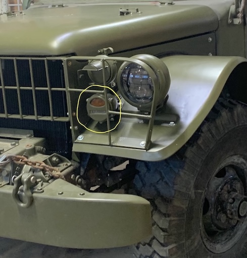

One of the bulbs burnt out in my front running light/blinker. (I'm totally spacing out on what you call those housings at the moment.)
As far as I can see, the burnt out bulb is a #1251 (28V and 6.44 watts). I've ordered a 10 pack as a replacement and some spares.
I see there is a similar bulb, #623. It appears to be identical, other than being 28 V, 10.36 Watts.
I'm wondering if that might also be an appropriate replacement, or is the higher wattage likely to cause heat issues in the small, sealed housing?

I don't know if it will bother the housing, but I did manage to melt the cover for the turn signal indicator!
Posts: 1274
Re: replacement bulbs?
If you're wiring is up to snuff, it will be fine in the housing. The current draw is higher, the candlepower is higher (brighter) it will create more heat.
If you're wiring is questionable, the added draw may not be a good thing.
Used in tight quarters or plastic housings/lenses, the heat may cause damage.
If one is using the plastic full round covers (originally fielded on Goats), never fit the larger lamp in the socket that is closer to the lens.
As others have learned, it will melt a hole in the cover.

Ended up buying a 10-pack of the 1251 bulbs on Amazon for $9. (28V, 6.44 watt) They seem to be working well.
I also ordered two Aero-Lites #303 LED bulbs, just to see how well they work in my truck. I installed one and it's working fine. Might be slightly brighter than the 1251 incandescent bulb. Of course, one of those bulbs cost as much as the 10-pack of the incandescent bulbs.
