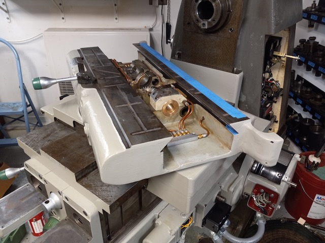

My engine is still not assembled, unfortunately. Last thing I was doing was cc matching the cylinder head chambers, but I've been busy with other work in the shop, including a major tear down and repair on my horizontal milling machine.

The milling machine (this is the one I posted a couple of years ago, machining the torque plate) is coming back together, but it's been a lot of work so far. Had to make a number of replacement parts, since this machine dates from 1966 and factory parts support is basically non-existent. One of its previous owners had used a water-based coolant (this machine was designed in the day of oil-based coolants and cutting fluids), which really gummed up and rusted the internal mechanisms in the saddle and universal housing.
