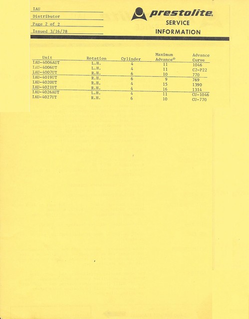

I found the timing curve in a Prestolite manual.
Thanks for your help
Re: Distributor Timing Curve

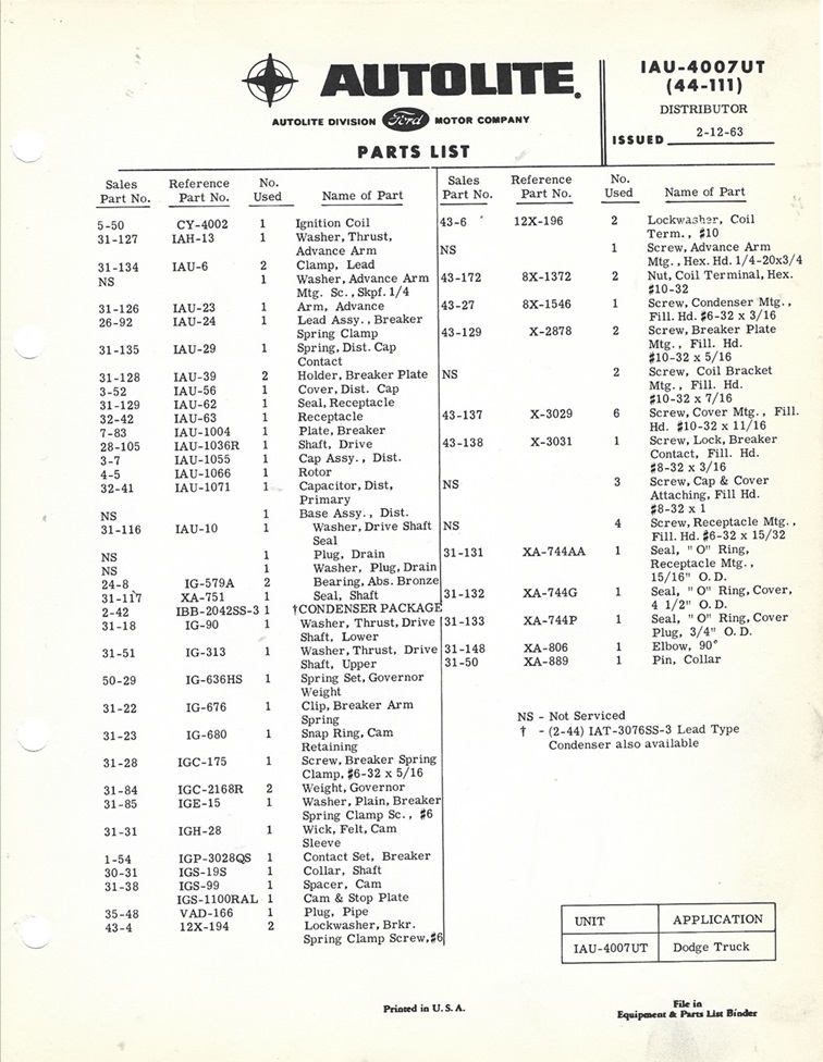

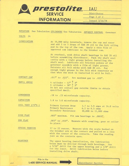

The IAU4007UT distributor is listed in the M37 ORD 9 SNL G-741 date 1954. The IAU-4005UT is also listed but for the 1st sn thru engine serial 20934. The IAU-4007UT starts at eng sn 20935 and on. The specs for both and advance curves are in the old 1960's AutoLite/Prestolite Service Manuals. The Army TM 9-1825B dated 1952 only lists the IAU-4004UT, IAU-4005UT & IAU-4006UT. The later units are not listed. The Prestolite service sheets date 1978 only lists the IAU-4006 thru IAU-4027 UT & AUT series.
IAU-4007UT xtrasm.jpg (221.3 KiB) Viewed 9926 times
Here's the advance curve sheet for the IAU-4007UT. It uses curve # 770.
