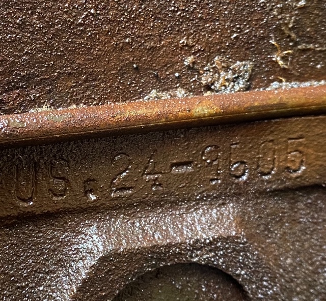

Anyone recognize this engine code: US.24-9605. I’m curious if it’s the original 230 flathead?
I’m going to find the rest of the numbers to add it to the registry.

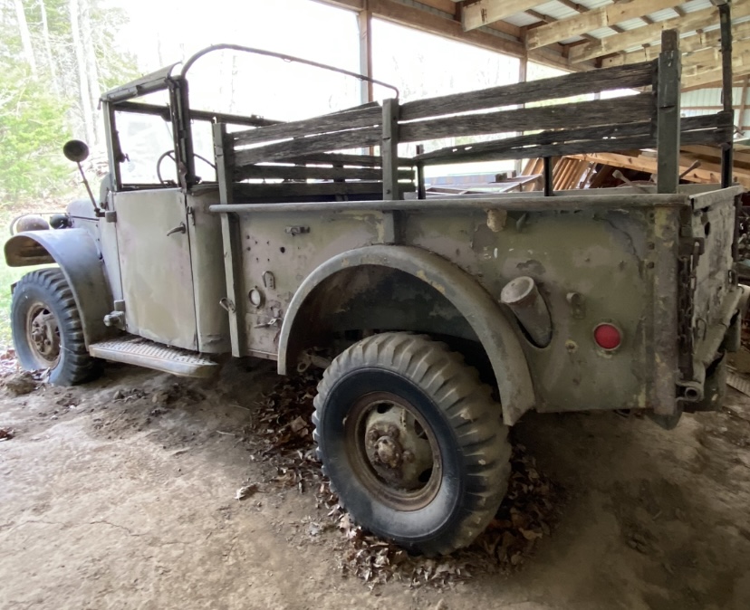

Thanks for checking in and posting. Looks like you have a nice straight truck. It appears that you've kept it under cover.

That block number is different than the usual T245 engine. Does it have the waterproof oil filler and dipstick? Those were unique features of the G741 series engines.

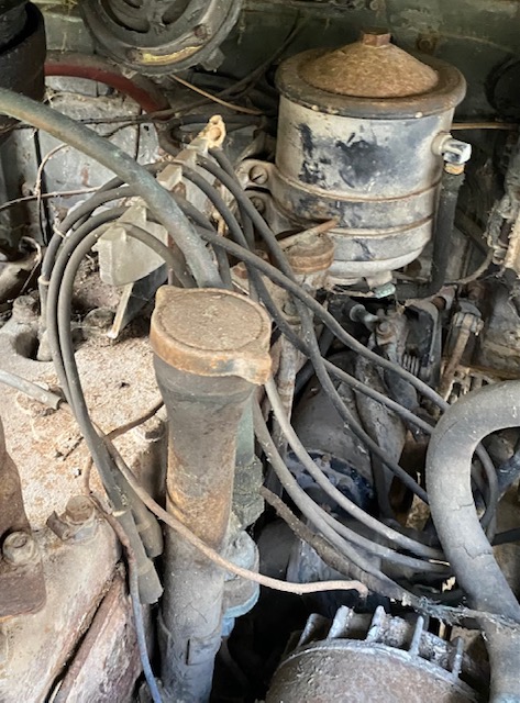

Regarding whether the motor has the waterproof oil fill tube and dipstick - it looks like it does to me. Here’s a pic
Oil filler and dipstick

Except for the spark plugs, cables, and cable clamp, the photo shows what appears to be an original installation.
