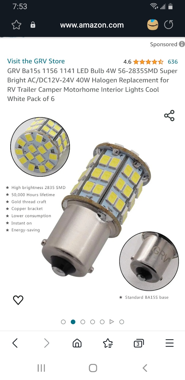

Re: Filament to LED Light Bulbs??
Post by Rdinatal »
The Stop/Turn bulbs can be changed with a LED 1156 rated at 12-24v. Since the Mil housings don't have reflected interiors be sure to get the ones with LEDs on the end.
Output is a little brighter than the dual filament bulb. At least there's some draw reduced on the minimal 25a generator.
