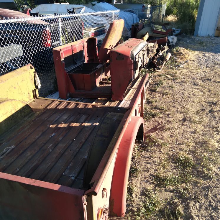

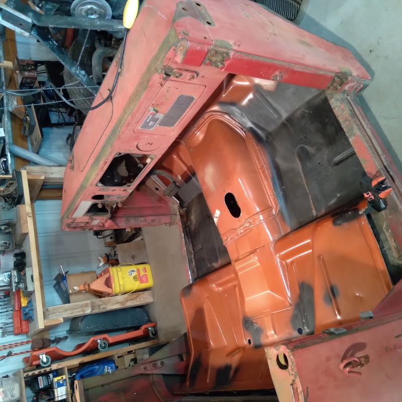

I had a great day. Cutting and splicing the two cabs together for the body swap... and never really knowing if the vision was going to work as it seemed in my head. A week of work with no sure outcome... and the possibility of ruining the cab parts I need to have.
But today it all came together. The firewall fits, the floor will fit with a little tweaking, and the body mounts will be where they should be so the steering column, brakes, and accelerator all fit without having to be modified.
WHOOP, WHOOP!!!

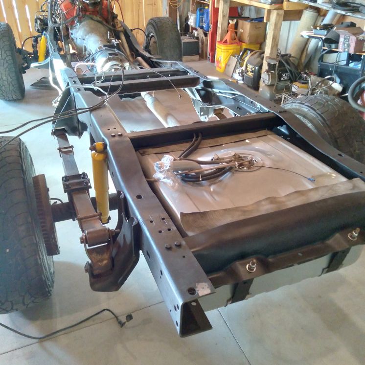

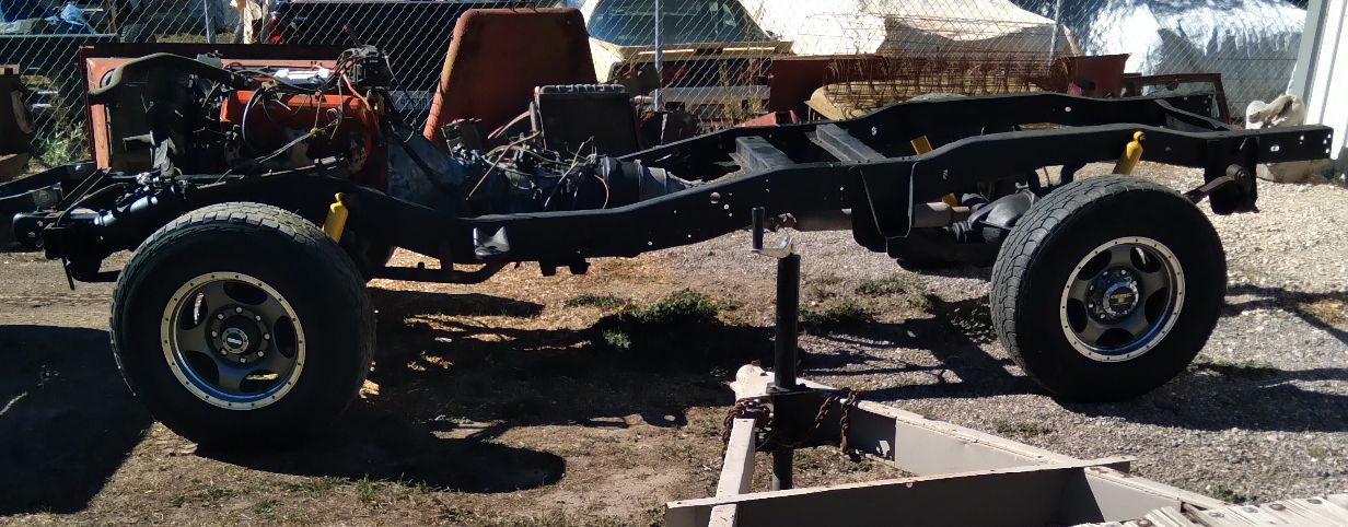

The chassis swap is looking good so far. The Chevy floor looks good in the M37 cab.
M37 floor.jpg (107.11 KiB) Viewed 14803 times
