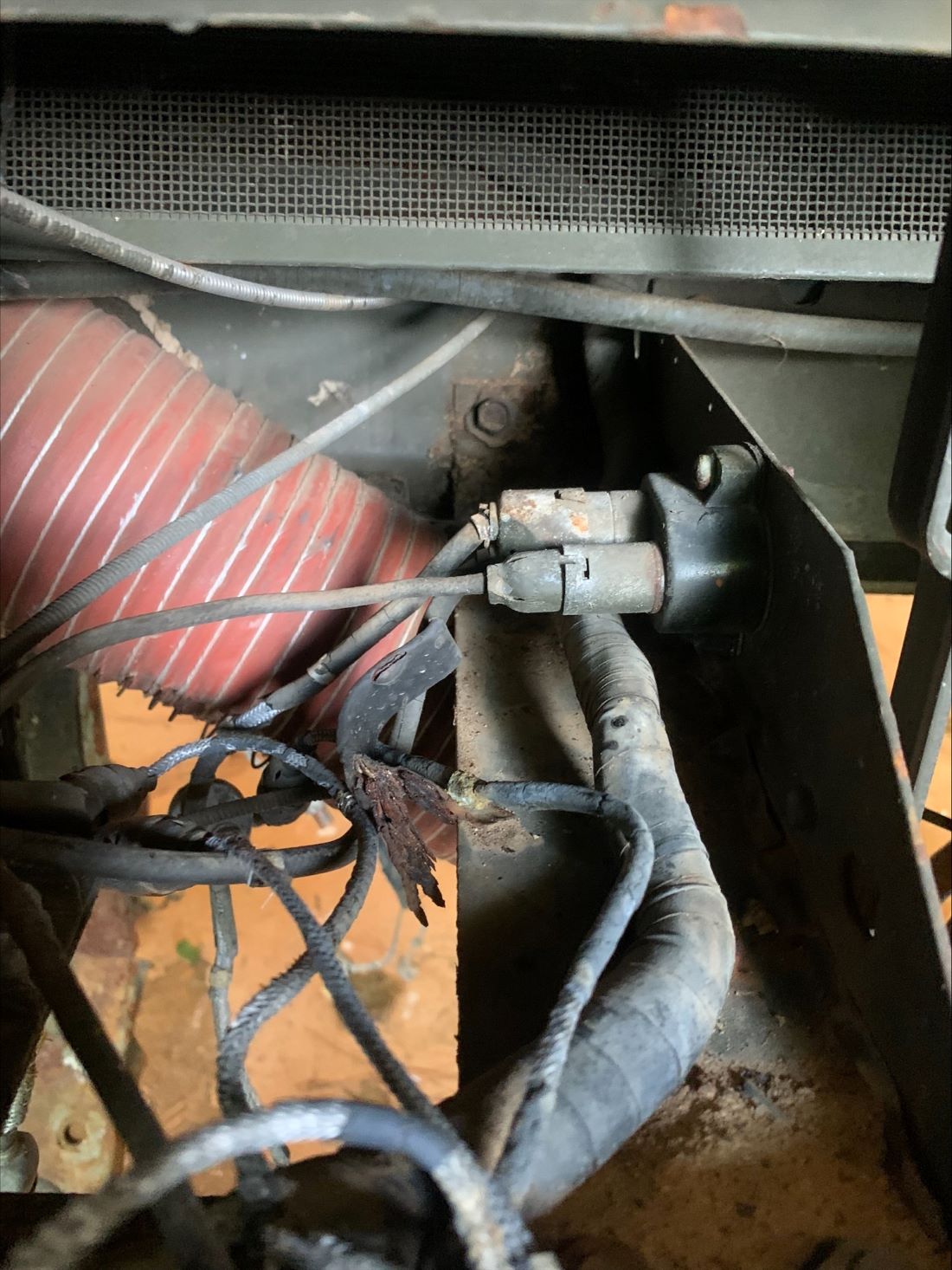

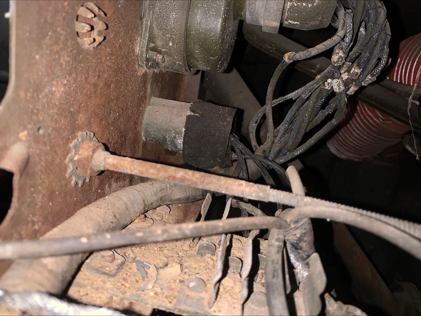

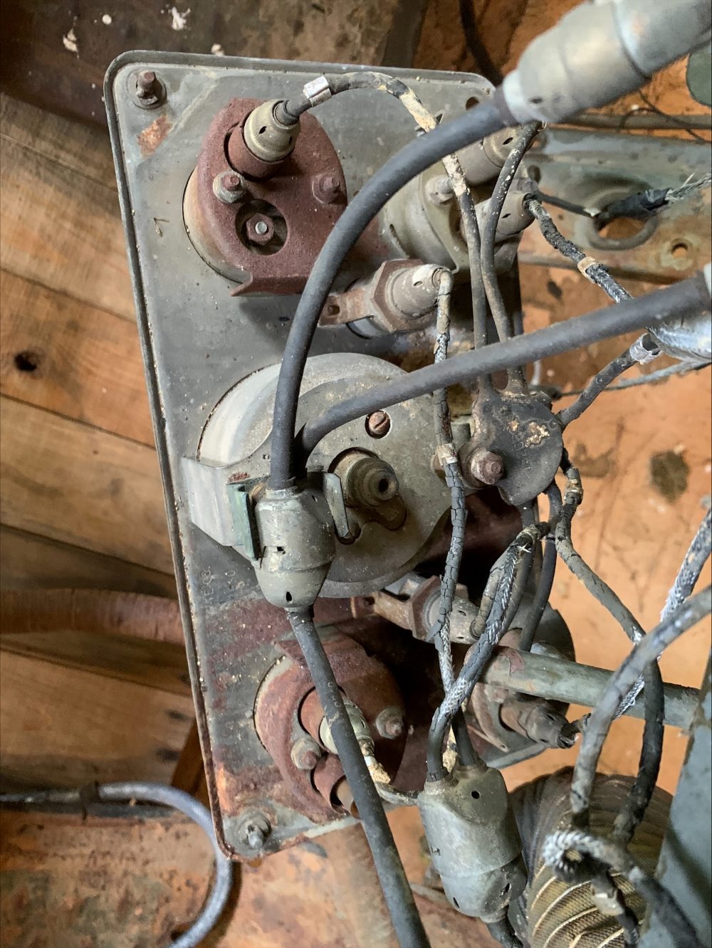

Does anyone have a photo of the firewall behind the dash. I'm looking to see how the wiring harness is routed and position of clamps. I failed to take a photo of mine when I took it apart. I've been through the manuals and can only find a reference about the harness being secured in three locations behind the dash. I'm almost ready to install the cab.

Not sure exactly what you're looking for...I'm in the process of similar work. I've attached 3 photos. Let me know if those do the trick. I'm happy to sent more photos, if you need them.

It is held with those u shaped hooks in 3 locations and mine also has the spring clamps for the 3 wire Douglas connectors holding them.
