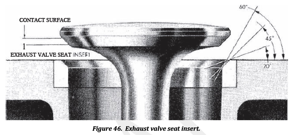

I have been searching around to see what the size / width of the 45 degree valve seat should be.
I am thinking of doing a 3 angle job on the seats of the flat head T245. Not finding much info I was going to do a standard size seat width with the 60/45/30 angles.
Then I found this reference to a Mopar Engine Manual.
Anyone on this board know if this is correct and or have done a three angle job?
Photo from this exchange - https://p15-d24.com/topic/44321-valve-v ... questions/

Old topic, I know, but I just found it.
The factory did specify a three angle seat profile: 60deg, 45deg, and 20deg. The 20deg is sort of an odd angle nowadays, but Neway still makes cutters in this diameter and angle. A more common 30deg would probably be okay.
Here's Fig. 46g from TM 9-1840A Engine and Clutch:
Screenshot 2023-05-03 at 9.00.05 PM.jpeg (145.49 KiB) Viewed 5851 times

That's interesting. I went with the 60, 45, 30deg. I wonder why they chose 20 deg. I don't see that gaining more performance. As long as the seat width is good the valves will not tell the difference.

I'm not sure of the history of the 20deg angle. The more common 30deg or even 15deg would work, at least as far as defining the upper boundary of the valve contact face. A flow bench would give some feedback as to which angles work better, but I've never seen a flathead block on a flow bench.

That 20 deg top cut is weird. From what I understand if the angles differences are 15 deg or less the flow will behave as if the seat is a radius cut. For the last motor we put together we used the typical 60-45-30 cut and back cut the valves 30 deg. The idea was to try and improve low lift flow since that's what would benefit the engine the most. Once we have the deck mowed down .015" on this motor we'll be doing quite a bit of work to restore the valve seats.
