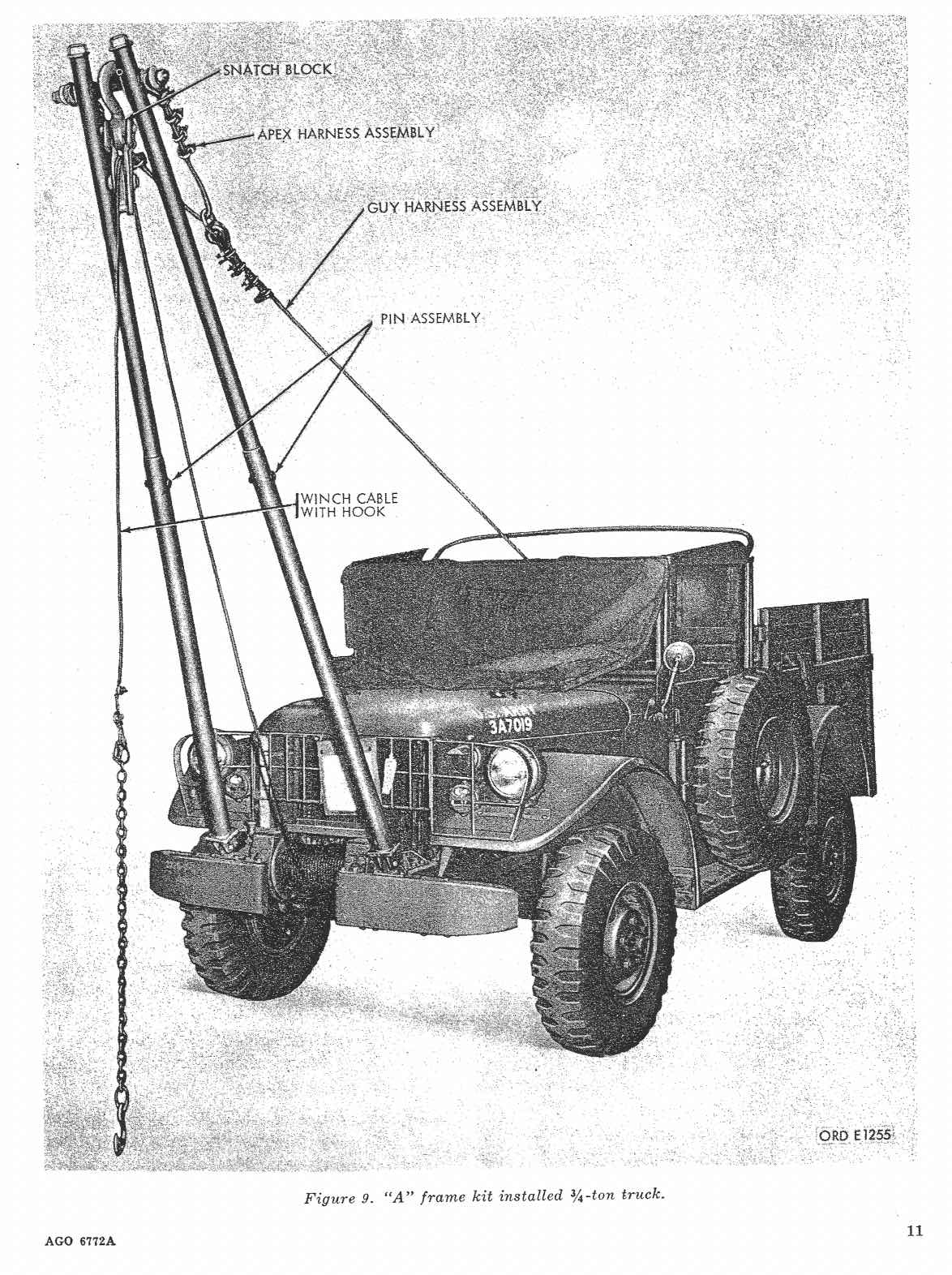

Anyone have a pic or the make/model/measurements of the snatch block used with the winch models?

The A-frame kit (TB9-2300-248-30) for the G741 trucks shows this snatch block:
M37 hoist small.jpg (243.67 KiB) Viewed 2291 times
I believe that it is a UW6. I have several of these on hand, and they seem about the right size. The block is in the ORD 9 book as p/n 7376463, Group 2001.1, but the description doesn't include a model or pulley diameter.
There's one for sale on eBay now, although it's a bit rough, with a broken part of the pulley, etc. But if you only need it for display, it might do. https://www.ebay.com/itm/265627963245?h ... R9rO6sPmYA

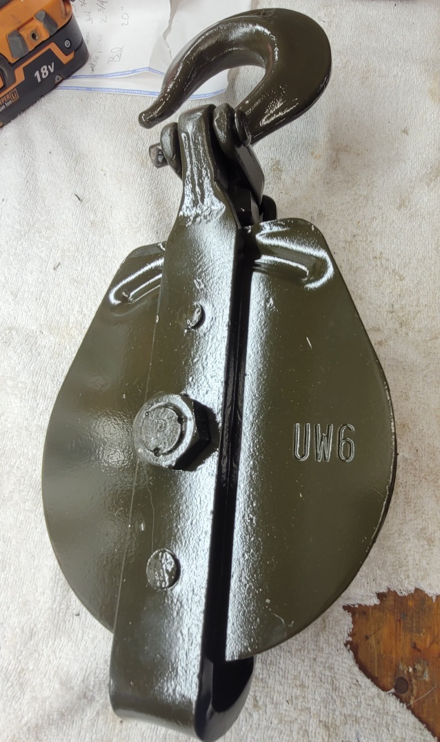

Found an inexpensive one. Disassembled, blasted, primed and painted. Looks better than new!

8)

Well done Murf-that looks awesome!
