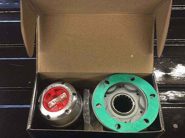

I picked up a set of the AVM hubs from John at Midwest Military.

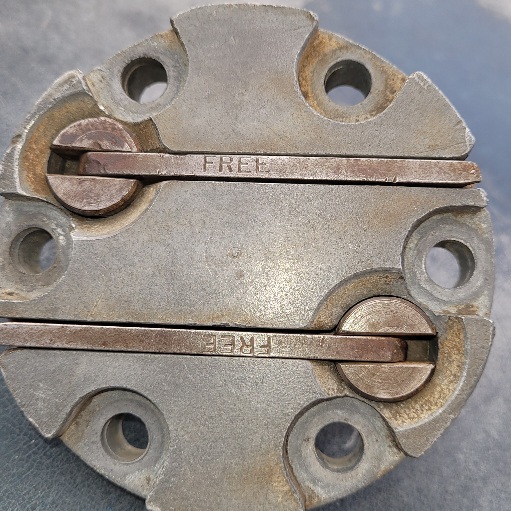

I just scored a set of Dual-Matic Hubs for the truck. I like the old "flatter" look as it seems to blend in with the age of the M. :wink:

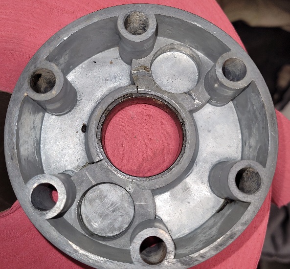

Well, Murphy's law struck again...one of them is cracked.. :cry:

A broken Dual-Matic is usually because only one arm was engaged and got in a tough situation.

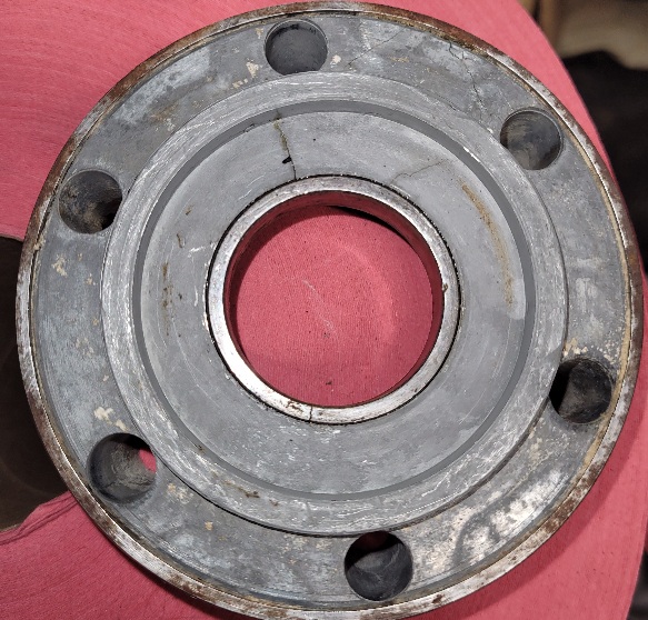

Very possible here.. as you can see, the cracks are small. The whole thing didn't grenade into chunks..
in the top pic you can see just where the gear (at an angle) just caught the housing a little.
In the bottom pic you can see where the angle also cracked the steel bushing .

The gear itself looks fine with only a mark across a couple of the internal splines. No cuts or gouges at all.
Re: Need model of manual hub locks
A decent shop can make you a new bushing.
Welding that alloy casting is another matter.
