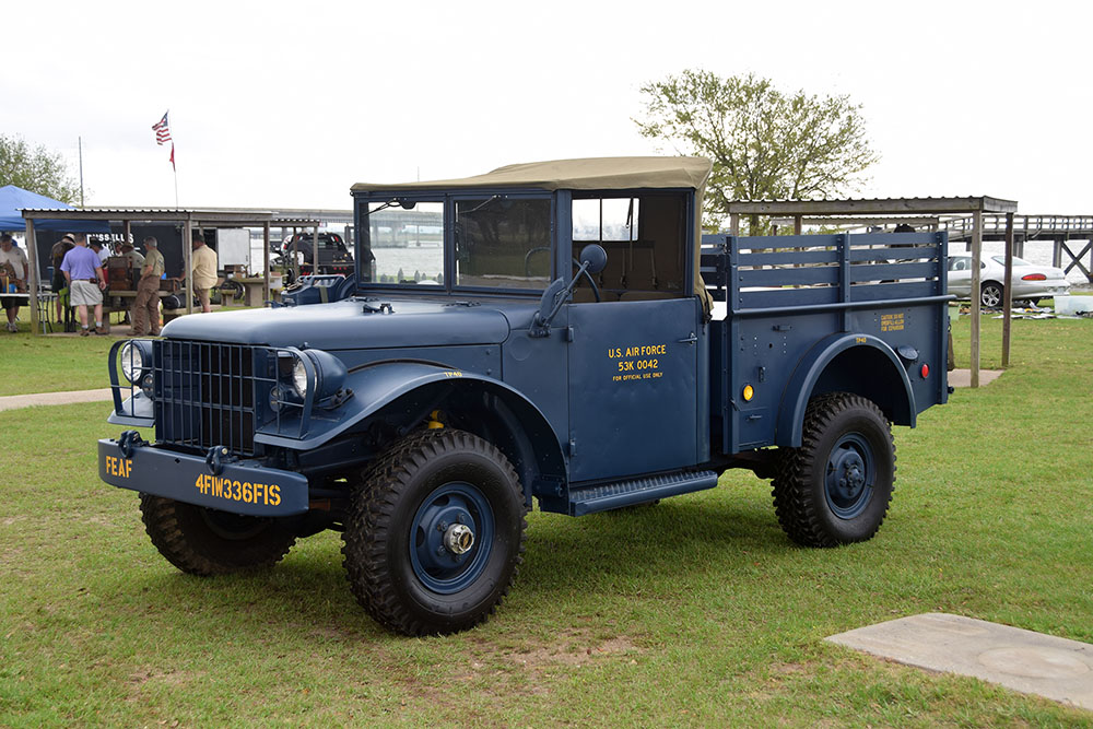

Hey John,
I thought you'd sold your truck. Did you end up keeping it?

Cal_Gary wrote:Hey John,
Good Heavens, no. :shock:
2019 BSS M37.jpg (206.61 KiB) Viewed 1349 times
-John

Excellent! :)
