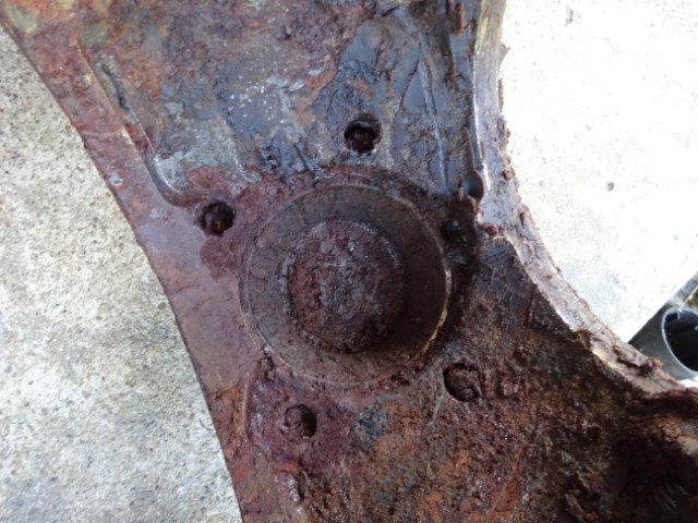

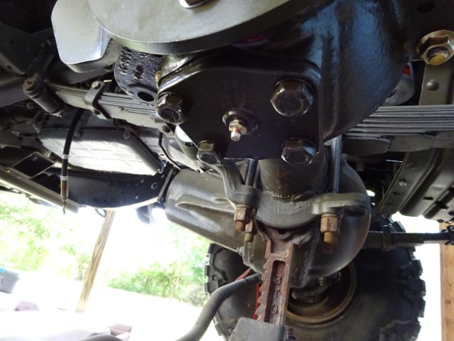

I would recommend installing a grease fitting on the bottom plate (bearing) the pics of mine when I took it apart shows no grease and a lot of rust. The knuckle was packed full of grease too when I took it apart.

Yikes - so far mine has appeared to be pretty well maintained. It was Wyoming/Colorado truck and garaged most of its life.

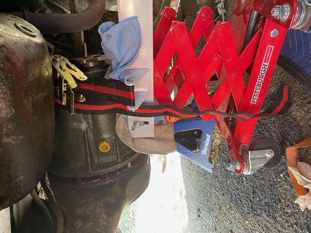

I picked up my rebuilt differentials and disc brake kit from M Series rebuild this week. Today I was able to get the rear differential installed. Per Charles’s advice, I used Permatex anaerobic gasket maker in lieu of an NOS gasket. It wasn’t too hard to get it back up in there, again using my harbor freight transmission jack. I couldn’t find any torque specifications in the manual so I torqued all the nuts to 45 ft lbs. Next up will be the front differential. Some of the studs are a little banged up from the truck’s past life so I’ll have to try to find some replacements from Midwest military or VPW.

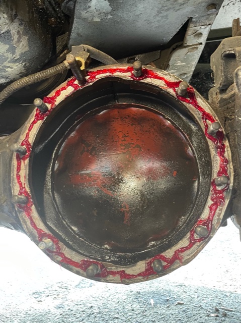

I completely forgot to take any pictures on the rear axle, so I snapped a few of the front. The front differential install went very smoothly as well. I again cleaned the mating surface and added a solid bead of anaerobic gasket maker, as well as removed and re-sealed all the studs. Vintage Power Wagons came through in a pinch and was able to source a replacement stud for me (one was damaged at some point and completely unusable). Again, the little Harbor Freight transmission jack worked perfectly. I accidently let the male and female components of rear propeller shaft separate. I could NOT get them back together; eventually I realized that the felt seal inside was completely gummed up so I ordered a replacement. The next step will be trimming it to shape and then getting the shaft back together.

Nice work-thanks for the pix too!

The NOS diff gasket is necessary for axle shaft alignment. the aftermarket are not the correct thickness.
