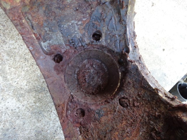

DSC01279 (Small).JPG (112.62 KiB) Viewed 1525 times
This is what I found when I opened up my knuckles--they were full of grease, but not at the bottom. The bearings were completly rusted up.
So, I put in a grease fitting so that I could flush the bottom bearing. A NPT plug might work, but I prefer to fill the bearings with new clean grease, not pumping the old dirty grease thru them.
