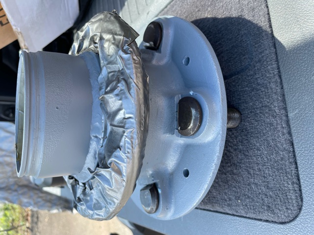

I’m starting a new thread here for the installation of my brake disc kit from M Series Rebuild (front axle only). This process would probably be a breeze for most people on this board, but I’ll add some pictures of my process in case it helps other newbies at some point in the future.
First step was to install my old wheel studs in the new hubs. In order for them to clear the rotor flange, I ground a 45 degree angle into the flat side of the stud heads heads. I used a 1” by 12” brass drift punch and a sledge hammer to drive them in, taking care to wrap the rotor flange with a healthy layer of duct tape to prevent damage to it. 7/10 studs went in without too much drama, but three of them were tough to seat. I ended up putting the studs in the freezer overnight and using a healthy amount of penetrating oil and sweat.

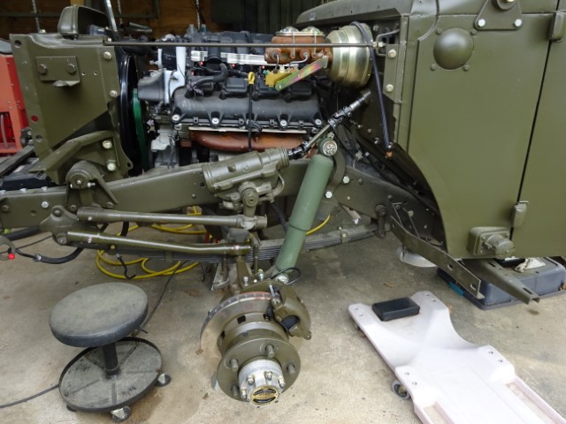

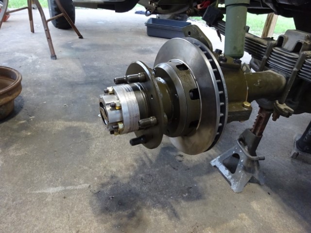

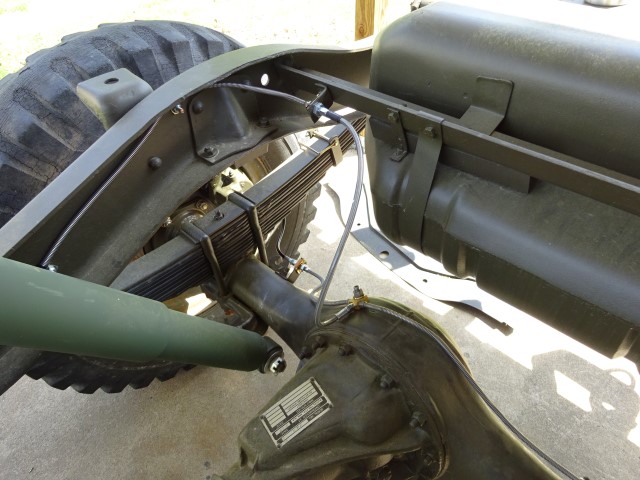

Re: Front Disc Brake Kit Installation
DSC01026 (Small).JPG (120.21 KiB) Viewed 1264 times
DSC01489 (Small).JPG (122.32 KiB) Viewed 1264 times
Here is my brake setup. I used Nicopp lines with SS armor-very easy to work with.
